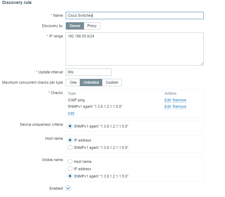

    i have set up discovery

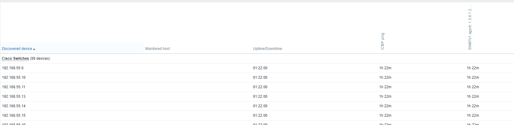

    and it works, as in monitoring ->discovery i see all my things

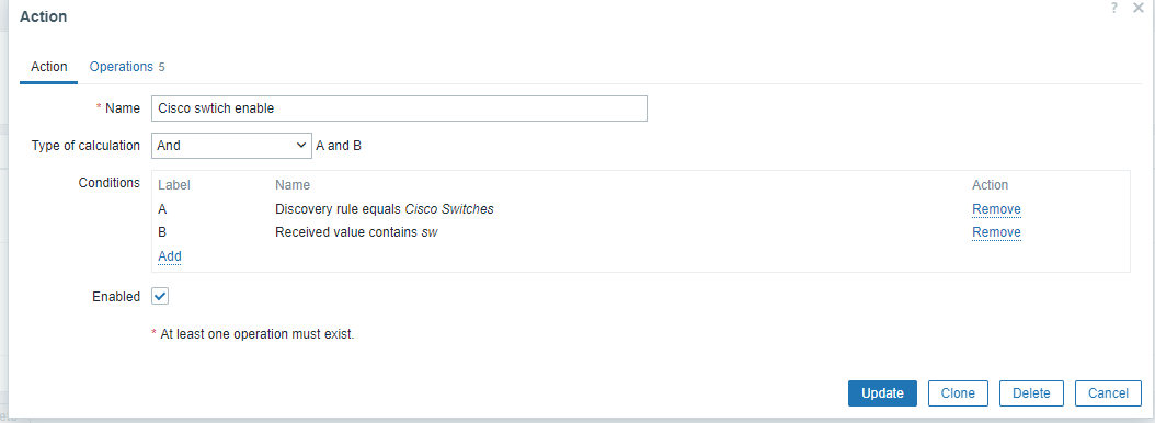

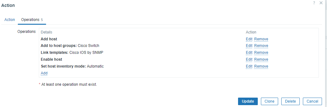

ID:	488379So now i want to auto add them to my hosts. The snmp check when done manually against my switches always returns sw_xxxx. And i want to use it as visible name for switches
    Unfortunately this part doesn't work. I would appreciate if someone could help or maybe point me where i can even debug what zabbix is doing. Like on discovry page i see it found snmp but not waht value zabbix recived etc.​​​
