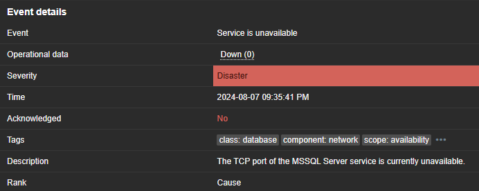

    This is what Zabbix is reporting:

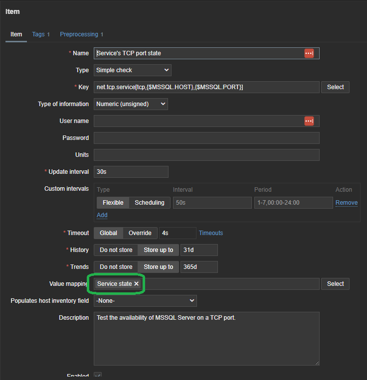

    Here is the configuration for the trigger, in case it holds any clues.​
    I double checked the macros on the host
    {$MSSQL.HOST} == localhost
    {$MSSQL.PORT} == 1433
    Perhaps it is the value mapping which turns 0 and 1 into Down and Up?
    But I'm thinking if that were the case, last(/LUCYTEST.mst.com/net.tcp.service[tcp,localhost,1433])=0 would not evaluate to true, as it would be "Down" instead of "0".
    I am a bit new to Zabbix, so I am probably just overlooking something simple.
    I would appreciate any pointers in the right direction.

    cyber
    • 4990
    Value mapping is for visual aid, calculations are still done on original value.
    ANd please change yout item type from simple check to "zabbix agent" or "zabbix agent (active)" and it should start working. "simple check" will be executed on server/proxy and most probably runs into wall and you get "no connection".
    you test with zabbix_get, which means it will be run through that particular agent of LUCYTEST.mst.com locally. Or you can also open FW hole from server to that host/port and it will work also as simple check...
