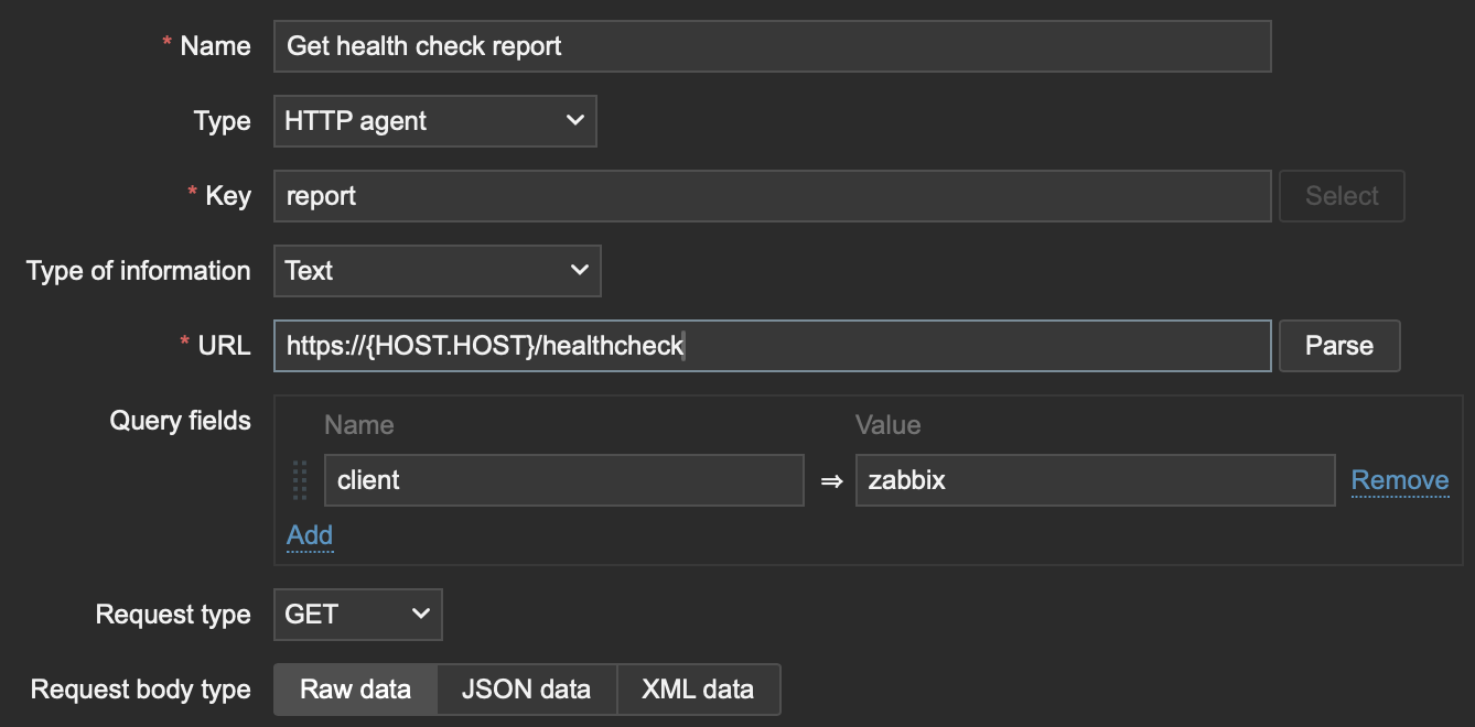

    I created a template and added an item like this:

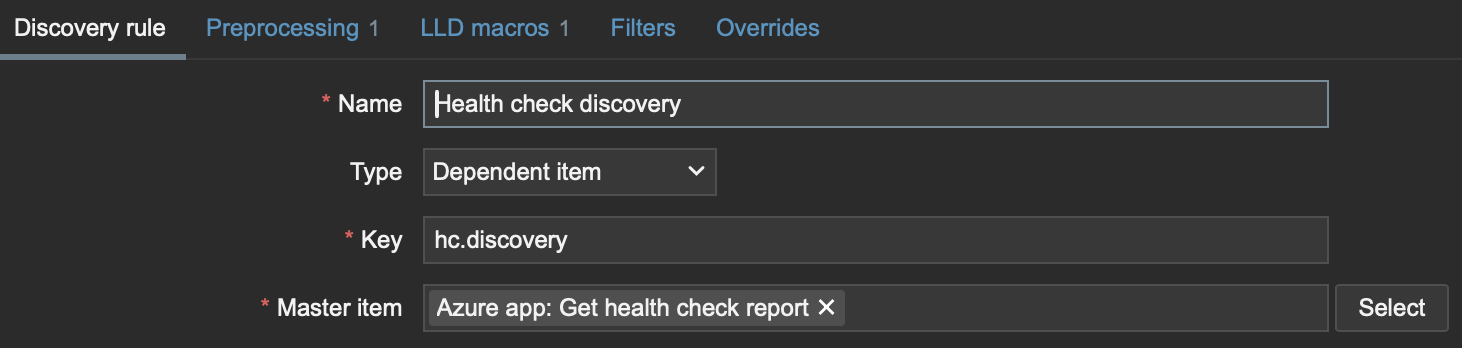

    Then added a discovery rule to that template:

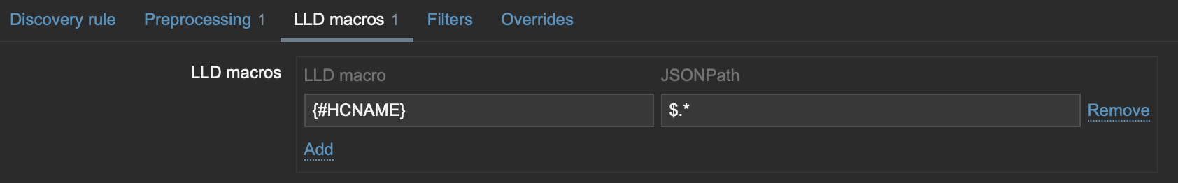

    And then define an LLD macro:

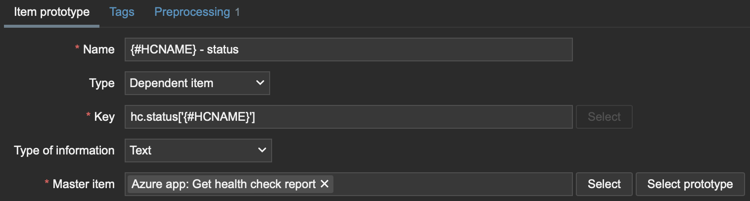

    Then added an item prototype for the discovery rule:

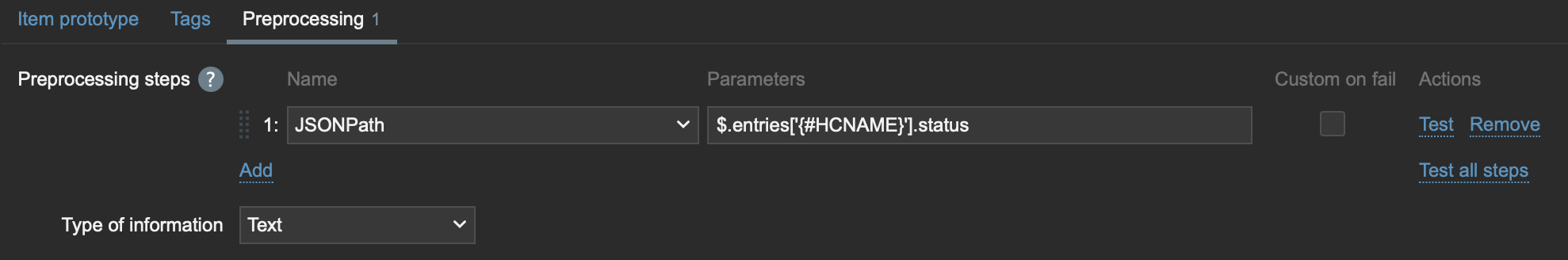

    It has the preprocessing setup like this:

    I am not too sure in this, but do you really need "$.entries[{#HCNAME}].status". You previously already preprocess it out in discovery... Shouldn't "$[{#HCNAME}].status" be enough? and you can always wrap object names in ''-s
    ['<name>'] Match object property by name.
    But as I said, I am not too sure in this.. :P jsonpath gives me headache every time..

      I think it is “$.entries[‘{#HCNAME}’].status” because you still pull the data from the original JSON report as the master item for the item prototype is still the report.
      I tried using simple quotes everywhere, still nothing. Problem is that I find no error anywhere, have no idea how to debug this.
