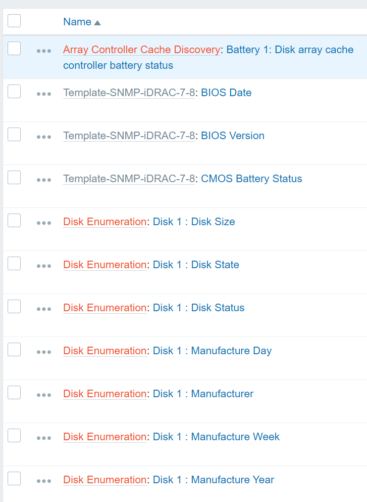

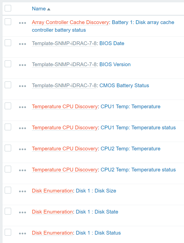

    I have added the same Zabbix template to multiple servers (Dell iDRAC interfaces) but some servers have CPU, Memory etc in its items, other don’t.
    All hosts have the same hardware, and BIOS version.
    Any idea why this is the case ?

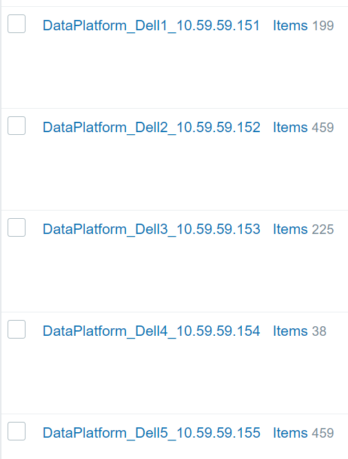

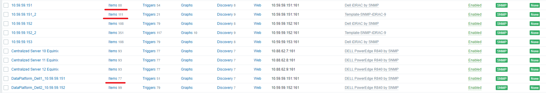

            What I did was get a different template and added it to the same servers, and found its always the same set of servers that show less items, but all servers have the same BIOS version, and exactly hardware.
            If you notice below server 151 has less items in all templates than server 152.
ID:	489852 Will run snmpget and see what I get..

                        The server 151 does not give the temperature table, which means that it does not have it (firmware?) or does the user have no rights to view (search for the words "view" or "zone" in the SNMP settings)
                        1) Check the sameness of the BIOS firmware on the servers.
                        2) check the rights of the test user (if you created it)
                        3) Try switching to using the SNMPv3 protocol.

                          151 BIOS information
                          HTML Code:
                          BIOS Version 1.3.7
                          iDRAC Firmware Version 3.15.17.15
                          iDRAC MAC Address 4c:d9:8f:b2:10:6f
                          152 BIOS information
                          HTML Code:
                          BIOS Version 1.3.7
                          iDRAC MAC Address 4c:d9:8f:b2:1f:e9​
                          test is not a user its the community string.
                          I'm looking into SNMP v3..
