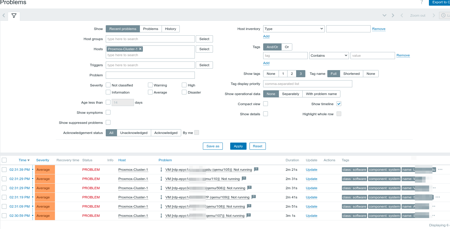

    Just installed fresh Zabbix 7.0 and added Proxmox (3node) cluster.
    After discovering qemu VMs i have list of "Problems" about turned off KVMs, CT. Some of them are even Templates of KVM which cannot be turned on.

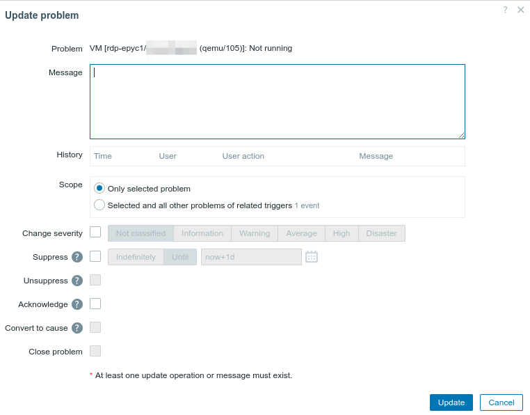

    I understand that i can Suppress any of those warnings Indefinitely or for some time.

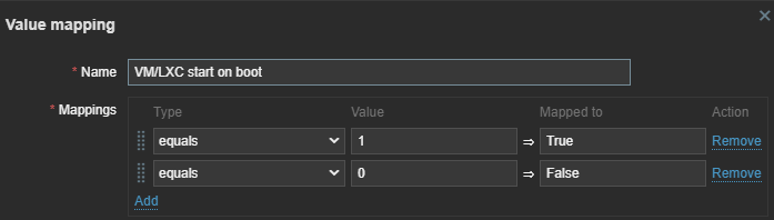

            Added this value mapping:

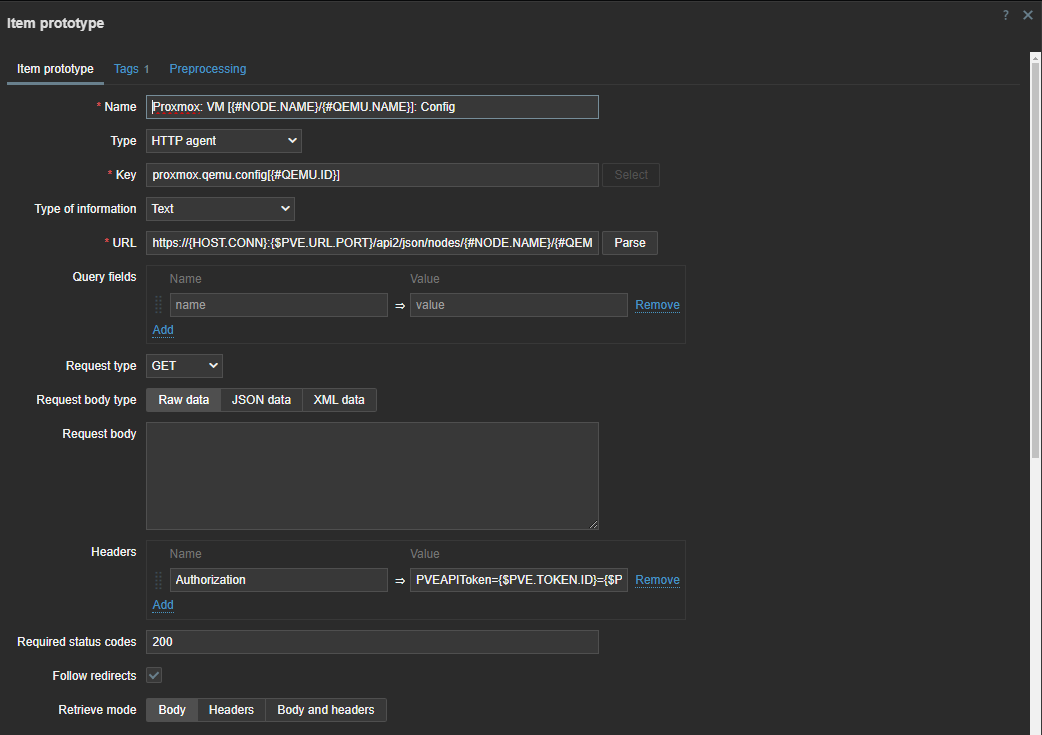

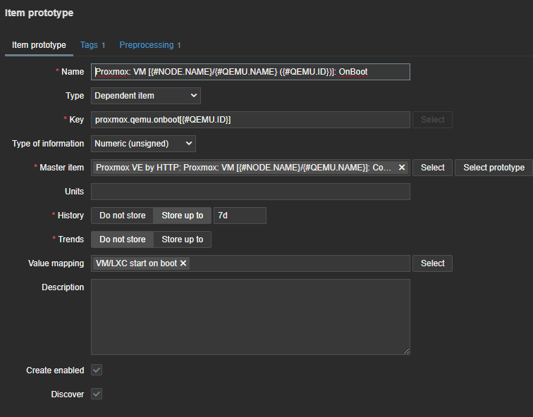

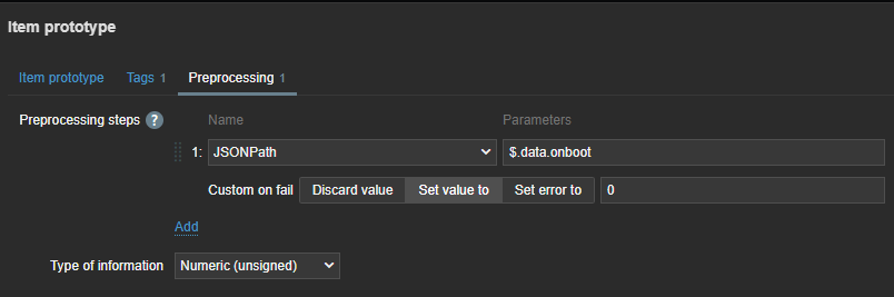

            Created this discovery in QEMU (and a similar one in LXC):
            Created this item prototype (and a similar one in LXC):Click image for larger version
            with this preprocessing:Click image for larger version

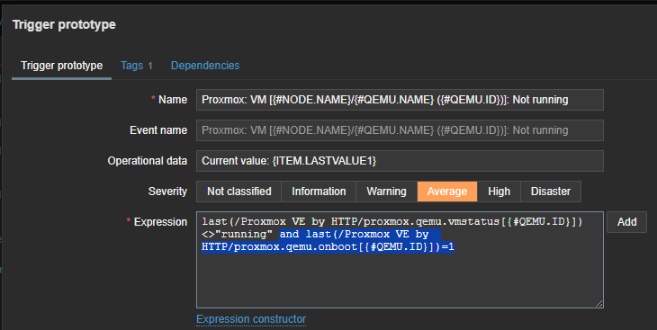

            Updated this trigger (and the LXC one) Note the highlighted area in the expression
            From my testing, it seems to work as I expected. Ran some backups of powered off (not set to start on boot) VM/LXC systems and they alerted only while they were powered on for the backup. As soon as the backup completed, the alert cleared.
            If you change the start on boot flag, within a min or 2 the alerts will update properly (close out or generate) as expected.​​
