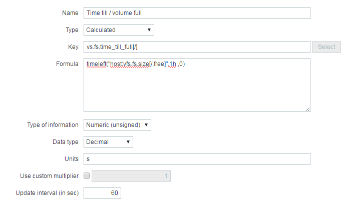

                  For that reason I started using "predictive" items (see attached image) to tell me when my disk will completely run out and then add a trigger to give me a 1 day notice.
                  Unfortunately the documentation is terrible and when you just use the prediction stuff in the trigger expression, you have no visibility of whether the trigger will work or not, which is why I'd prefer to add a calculated item!
                  For example see this thread with regards to prediction https://www.zabbix.com/forum/showthread.php?t=54455
