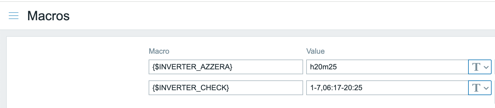

    I have a MACRO defined like this:
    {$INVERTER_CHECK} = 1-7,05:50-21:00

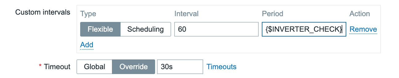

    The MACRO is used in an item's custom interval value:
    Type = Flexible
    Interval = 60
    Period = {$INVERTER_CHECK}​

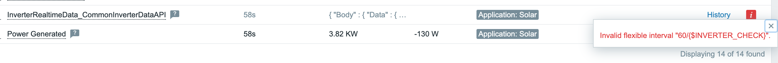

    After upgrading to version 7 the MACRO string value is not accepted anymore. The item is not run and this error appears:
    Invalid scheduling interval "{$INVERTER_CHECK}"​

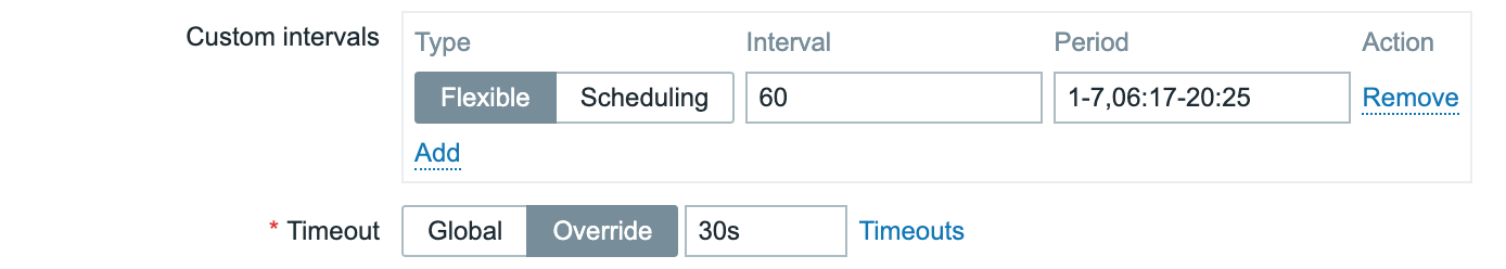

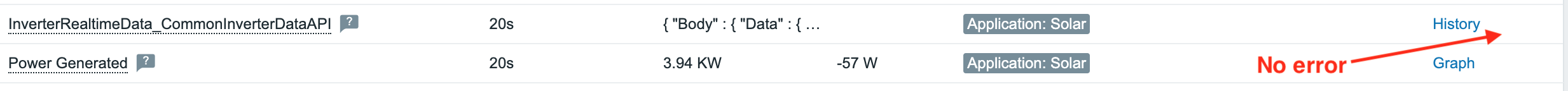

    The item runs without errors if the MACRO string is substituted with the actual value:
    Type = Flexible
    Interval = 60
    Period = 1-7,05:50-21:00
