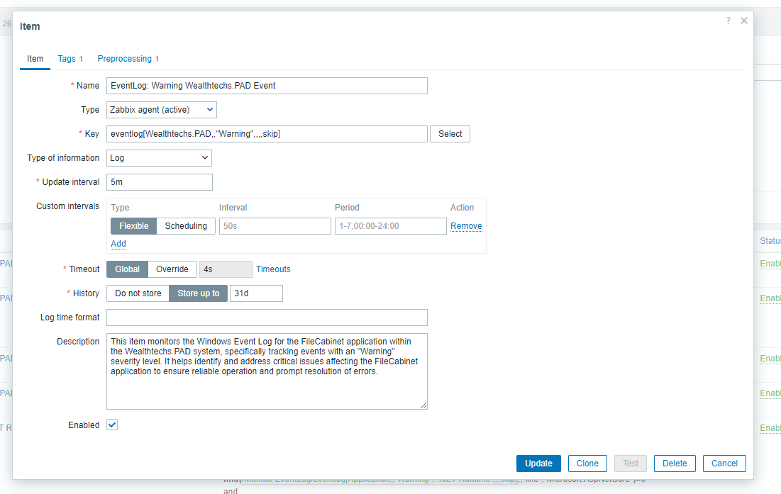

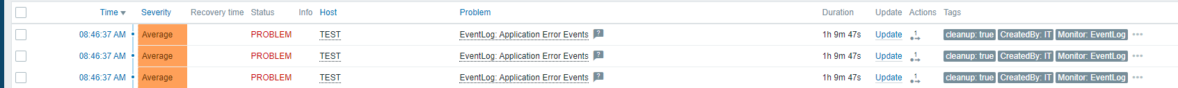

    Hi, I have an item that collects information from the eventlog, and its corresponding trigger that can be generated multiple times and can be closed by hand.
    The problem I have is that I get a lot of problems with these events, my idea is that they close automatically. What I care about is that I send the alert via telegram for this event.
    I was trying to get a recovery event with NODATA, but I can't get it to work.
    Has anyone found a solution to this?
    Thanks!

      Hi, thanks for your response
Name:	Screenshot 2024-08-27 104851.png
Name:	Screenshot 2024-08-27 105047.png

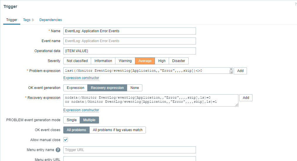

          Sorry for that. I swear that I uploaded the trigger image.
          I resolved the problem using on this way. I don't know is this is the better way to make this
          Click image for larger version  Name:	Screenshot 2024-08-28 104120.png Views:	0 Size:	47.5 KB ID:	490386
          The only problem I have with this way I have it set up is when more than one event of the same type arrives at the same time and it doesn't solve the problem for me.
          Click image for larger version  Name:	image.png Views:	0 Size:	8.0 KB ID:	490387

            This does not work...
            first of ... some basics... Recovery expression is ADDITIONAL expression that has to become true AFTER main expression has become FALSE...
            You see, your main expression is always true, last value is not 0 always... So no matter, what you write into recovery, it will not be considered. For me looks kind of weird to compare a log item to 0 anyway, but in general it works...
            So you need to add that nodata() condition into main expression.
            ... and nodata(/host/item,1m)=1
            this will close the problem after 1 minute if there is no new data... You have check interval at 5 minutes, so it pretty sure, that after a minute ther eis no new data ..
            Second piece of basics: Nodata is recalculated in every 30s, so using 1s there does nto work... (from docs: sec period should not be less than 30 seconds because the history syncer process calculates this function only every 30 seconds.). so use at least 30s there or longer.
