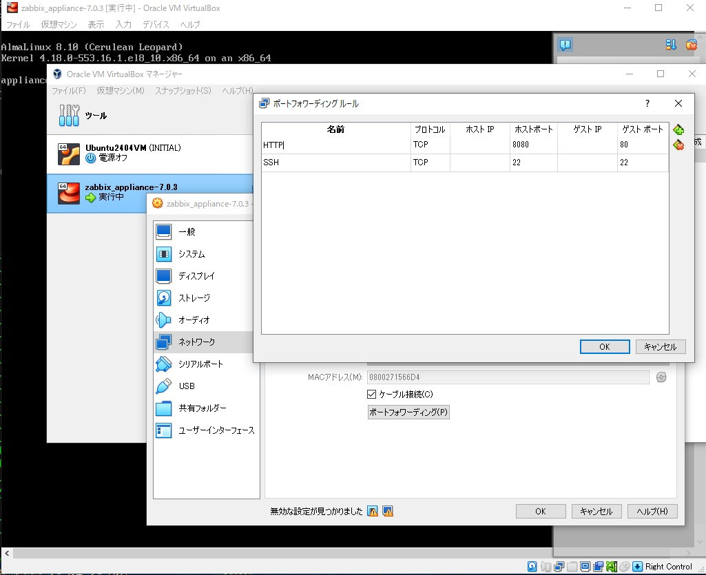

    I want to test the new version of Zabbix. But I want to test it with using Oracle VirtualBox. But I have a problem to access to the web page. And I'm not also able to ping the ip adress of the virtual machine. I run on Windows 11.
    I need help

    When you import the appliance, aren't the VM's network settings set to NAT? You can try out the web screen by setting up port forwarding and accessing http://127.0.0.1:8080/ in the example shown.
    *: Sorry, this is a Japanese version of the image.
    *2: If communication is initiated from a VM, port forwarding settings are not required, so the appliance can collect metrics from external agents.

        Many thanks for you help. Now I'm able to access to the Zabbix webpage and Zabbix server in ssh.
        I use NAT network.
