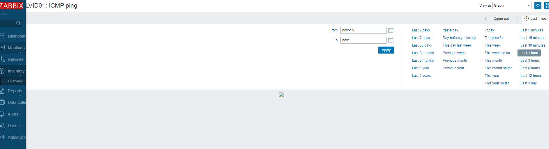

    Hello, I manage to create a new server and migrate config and database to it. Now I'm getting no errors on zabbix_server.log neither on syslog. Hots are ok and so.
    Instalation on debian 12 mariadb10.11 zabbix7.
    The problem is when i access any graph or map, it show nothing.
    Any idea what the problem is ?
Name:	Screenshot 2024-08-28 175210.png
  • f4bioc
    • Aug 2024
    I manage to find out that the problem was on my zabbix/local/conf/brand.conf.php file
    After a new server creation and db upgrades I catch that when apply my rebranding file, it stop working graphs and maps, also the rebranding settings were visible. Maybe some sintax ou identation on the file.
