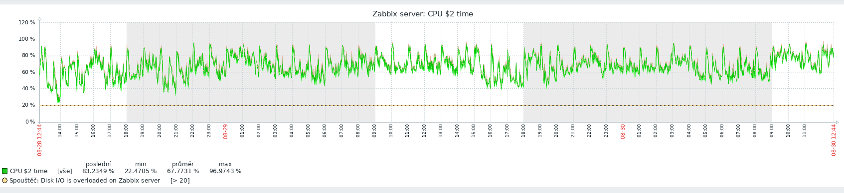

    We have about 30 proxies connected to our Zabbix server and total of 183.15 new values per second. I am constantly getting trigger Zabbix history syncer processes more than 75% busy (multiple times a day, usually lasting about 5 - 15 minutes) and trigger Zabbix housekeeper processes more than 75% busy which everytime last for few hours until cancelled. Also Disk I/O is overloaded on Zabbix server is triggered for 6 days now (graph in attachement).

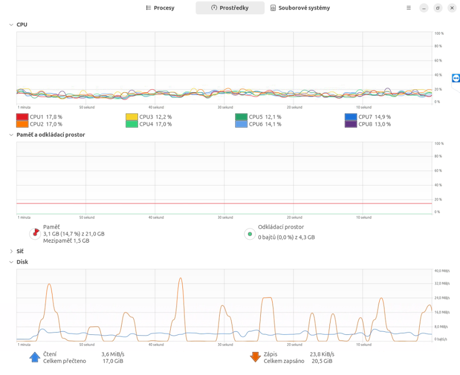

      Thank youfor your answer, but IMHO CPU or RAM is not the problem, because CPU utilization is constantly about 30% and I have 50% of ram free. But just to be sure I added four more vCPU and 12GB RAM to Zabbix virtual machine. But I don't see any performance change after this. I uploaded ubuntu resources screenshot, maybe it will help. What I find shocking is data writen. In less then hour of Zabbix server runtime there is 20GB written to disk and I think it is too much. But I am unable to find which process is doing the writing. I don't think that all praxies and hosts monitored will generate that amount of new data in less than one hour. Any thoughts?
