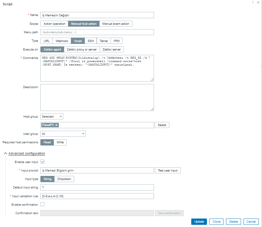

    Hello Eveyone,
    I'm newbie on zabbix. I create a script and its simply modify a custom registry on windows host with users custom input, but when i trying to run script as user (User type is User) script doesn't run because of permission. When i unchecked "Enable user input" the script is running as aspected, but this time can't achieve what i intended. It's a bug or what am I doing wrong?
    Youtube video:
    User rights;
    ​Scipt;

    Maybe you will find the answer here: https://www.zabbix.com/documentation...ual-user-input
