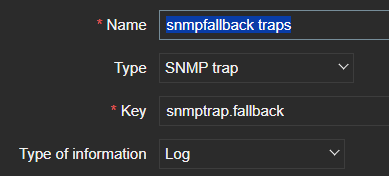

    • 4996
    Set your items "type of information" to "log". It seems to be "numeric(unsigned)" for now...
    • vastseasailor
      • Sep 2024
      Thank you cyber, this worked instantly.
