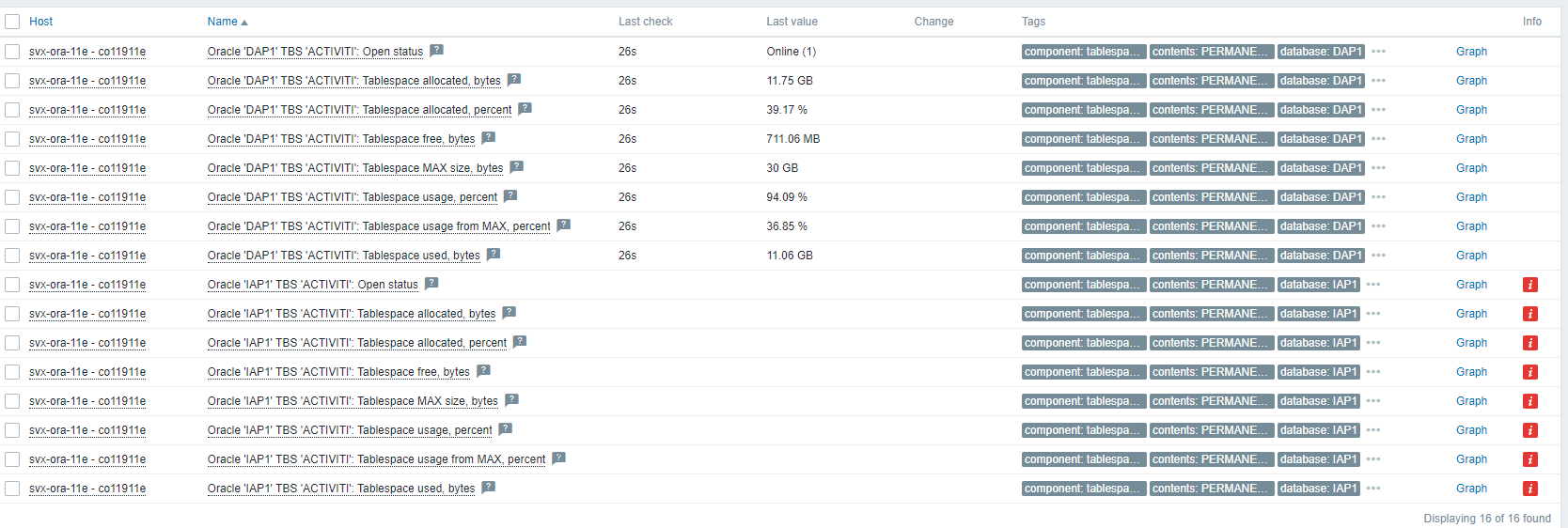

    I need help to understand if it's correctly set and if I need other setting. The reason is that I have many errors with Dependens Items for the PDB IAP1. See below an exemple of error:
    [root@svx-mon-02p ~]# zabbix_get -s svx-ora-11e -k oracle.ts.stats["tcp://svx-ora-11e:1521","zabbix","password","co11911e.unifr.ch ","ACTIVITI","PERMANENT","DAP1"]
    [{"ACTIVITI":{"contents":"PERMANENT","file_bytes ":1 2616466432,"max_bytes":32212254720,"free_bytes":74 5603072,"used_bytes":11870863360,"used_pct_max":39 .17,"used_file_pct":94.09,"used_from_max_pct":36.8 5,"status":1}}]
    [root@svx-mon-02p ~]# zabbix_get -s svx-ora-11e -k oracle.ts.stats["tcp://svx-ora-11e:1521","zabbix","password","co11911e.unifr.ch ","ACTIVITI","PERMANENT","IAP1"]
    [root@svx-mon-02p ~]#​
    And on the Zabbix console server, I see the error message:
    Preprocessing failed for:
    1. Failed: cannot extract value from json by path "$..['ACTIVITI'].status.first()": invalid object format, expected opening character '{' or '[' at: ''​

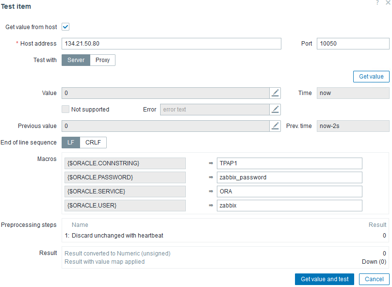

        Then I have create a new host on the Web console page of Zabbix with setting only the parameter :
        {$ORACLE.CONNSTRING} = TPAP1
        Then I see the following error on the oracle.ping item :
        Connection to database is unavailable
        If I test the oracle.ping I see the following value of the paremeter.
        Why I do not see the correct value of {$ORALCE.PASSWORD} and $ORACLE.SERVICE} ?
        I need help
        Thanks for your help
        Regards
        Olivier
          • 4996
          Item is never going to look it up from your plugin config on a remote server... What you see is in your template or host macros... I think you should remove everything besides {$ORACLE.CONNSTRING}
          (I have not used that plugin myself... )
