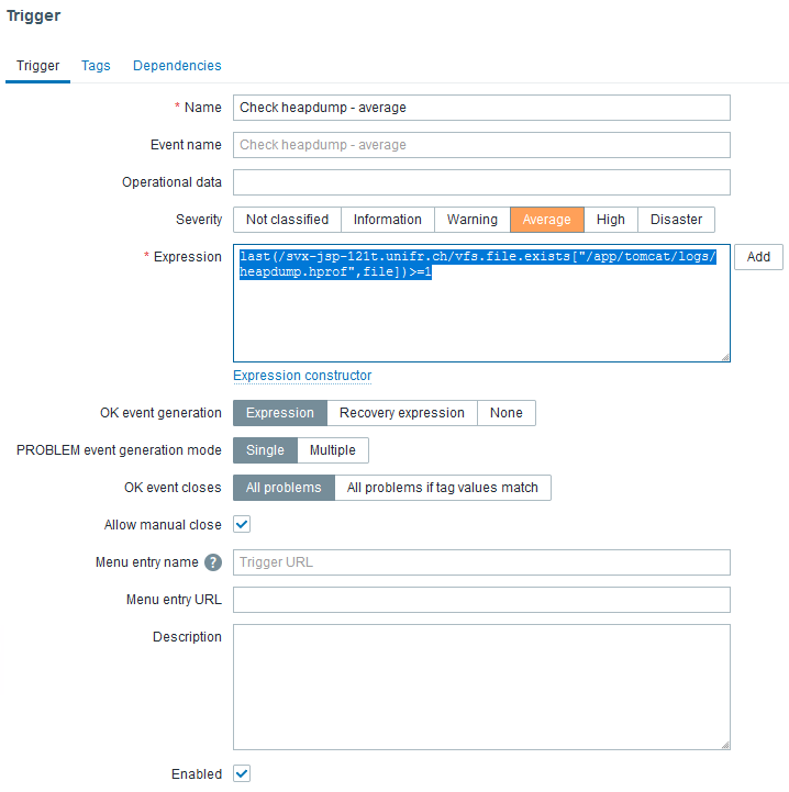

    Then I have create a trigger to alert me when the file was created as follow with success:
    last(/svx-jsp-121t.unifr.ch/vfs.file.exists["/app/tomcat/logs/heapdump.hprof",file])>=1
    Now I want to create a new trigger on this same item to alert me that the file was create more than 3 days with High severity. And close the first trigger alert. How can do that ?
    Thanks for you help

    min(/svx-jsp-121t.unifr.ch/vfs.file.exists["/app/tomcat/logs/heapdump.hprof",file],3d)>0 (lowest value during last 3d is above 0, meaning effectively, that it has been there for 3 days, all checks during that period have returned 1 (file is present)... )
    Closing the other one is tricky as its condition is still true, you can probably add some dependency there (https://www.zabbix.com/documentation...s/dependencies), so it might dissapear, but it will not make trigger to become false...
