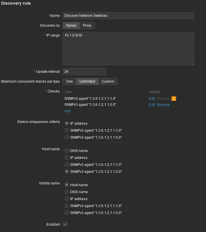

    New to Zabbix. Trying to replace my PRTG with it.

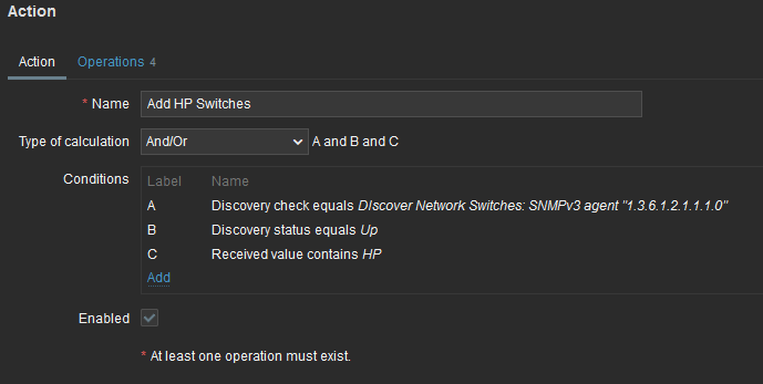

    I setup a quick server and installed Zabbix for testing. Created a discovery rule to find network switches, using SNMPv3 checks. My discovery action will use one of the checks to look for a value and then add it as a host. This worked.
    Created a new server for production and created the discovery rules and actions exactly the same. Initially only 8 devices were found. Thinking I did something wrong, I reverted my server back to pre-Zabbix installation and reinstalled. Now no devices are being found.
    The only difference between my test server and production server is the subnet it is on. I know the switches are accessible from the new subnet as I've tested with an SNMP tester as well as snmpwalk on the Zabbix server.
    Any assistance would be greatly appreciated.

    To add some more information, believing that it might be a firewall issue, I moved my installation to the same network as the devices I am trying to discover but that still did not work.
    Using the same credentials, I am able to add a device individually but not through discovery.
    I was using macro variables for the username and password, but have since replaced them with static values

      Here's some more follow up, in case anyone is able to help.
      I found some more tutorials about SNMP discovery and one of them included showing a tcpdump of snmp packets to verify devices are responding.
      tcpdump -n -s0 port 161 and udp
      After running the command, and recreating my discovery rule, again, I did indeed see that devices were responding to the SNMP request, but still only 7 devices show up in Monitoring>Discovery. No errors show in the server log either.
      Click image for larger version  Name:	image.png Views:	0 Size:	55.7 KB ID:	494266
      • bharned
        • Aug 2024
        • 9
        For those of you keeping up, I added SNMPv2 to a test switch I have, and created a discovery rule using that community. This test was successful. The problem is we cannot use anything but SNMPv3 due to security protocols.
        For some S&Gs, I created another discovery rule, only for my test switch, using SNMPv3. And it was discovered.
        I've cleared the cache before and recreated the original rule with a long update interval, but the rule never would find anything new.
        ANY help will be appreciated.
