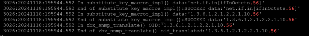

    Next i increased the polling logger to see it from th zabbix perspective. We can see Zabbix polling the item.
Name:	Screenshot 2024-11-18 200031.png

      When i try this, i can see the Bits Received and Bits Send being polled with tcpdump
Name:	Screenshot 2024-11-20 105759.png
      When i grep the log for queries on those two items i can see these. Bits received is not saved in history_uint
Name:	Screenshot 2024-11-20 105815.png
      When i examine the log for futher info, i can see these errors. It looks like zabbix has no value for this polled item. But we know from the tcpdump that snmp returned a valid value.

            With more debugging on, it seems the value after preprocessing is empty;
            Bits Send has Value returned from pre-processing
             29753:20241120:183235.437 [3] pp_worker_entry() process task type:5 itemid:50735
             29753:20241120:183235.437 [3] In pp_execute(): value:2232498461 type:uint64
             29753:20241120:183235.437 [3] In pp_execute_step() step:10 params:'' value:'2232498461' cache:(nil)
             29753:20241120:183235.437 [3] In zbx_dc_expand_user_and_func_macros() ''
             29753:20241120:183235.437 [3] End of zbx_dc_expand_user_and_func_macros() ''
             29753:20241120:183235.437 [3] End of pp_execute_step() ret:SUCCEED value:3486863
             29753:20241120:183235.437 [3] In pp_execute_step() step:1 params:'8' value:'3486863' cache:(nil)
             29753:20241120:183235.437 [3] In zbx_dc_expand_user_and_func_macros() '8'
             29753:20241120:183235.437 [3] End of zbx_dc_expand_user_and_func_macros() '8'
             29753:20241120:183235.437 [3] End of pp_execute_step() ret:SUCCEED value:27894904
             29753:20241120:183235.437 [3] End of pp_execute(): value:'27894904' type:uint64
            Bits Received has no value returned from pre-processing
             29753:20241120:183244.435 [2] pp_worker_entry() process task type:5 itemid:50564
             29753:20241120:183244.435 [2] In pp_execute(): value:611136069 type:uint64
             29753:20241120:183244.435 [2] In pp_execute_step() step:10 params:'' value:'611136069' cache:(nil)
             29753:20241120:183244.435 [2] In zbx_dc_expand_user_and_func_macros() ''
             29753:20241120:183244.435 [2] End of zbx_dc_expand_user_and_func_macros() ''
             29753:20241120:183244.435 [2] End of pp_execute_step() ret:SUCCEED value:
             29753:20241120:183244.435 [2] End of pp_execute(): value:'' type:none​
