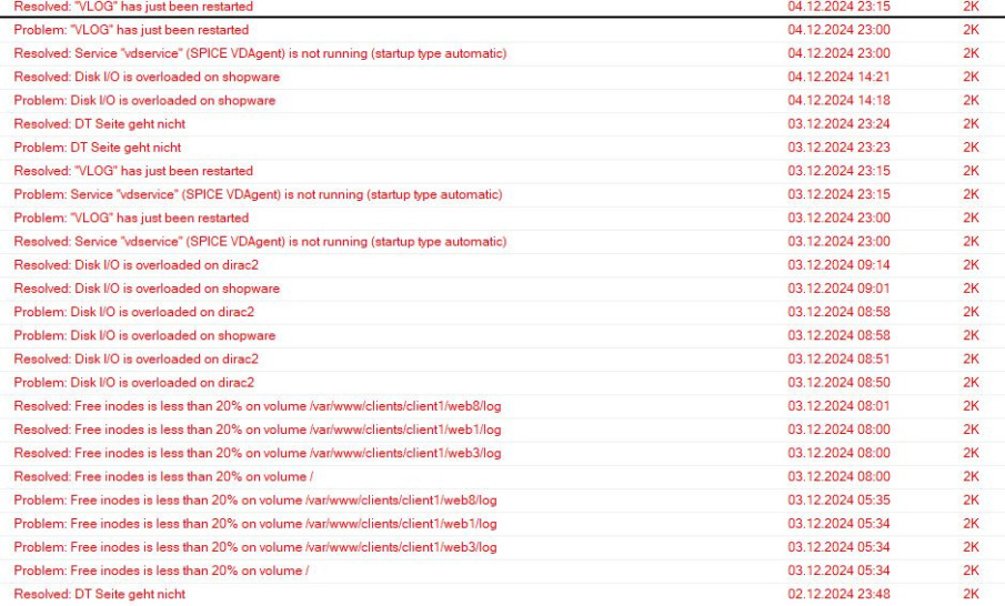

        Here as example the amount of emails from yesterday:

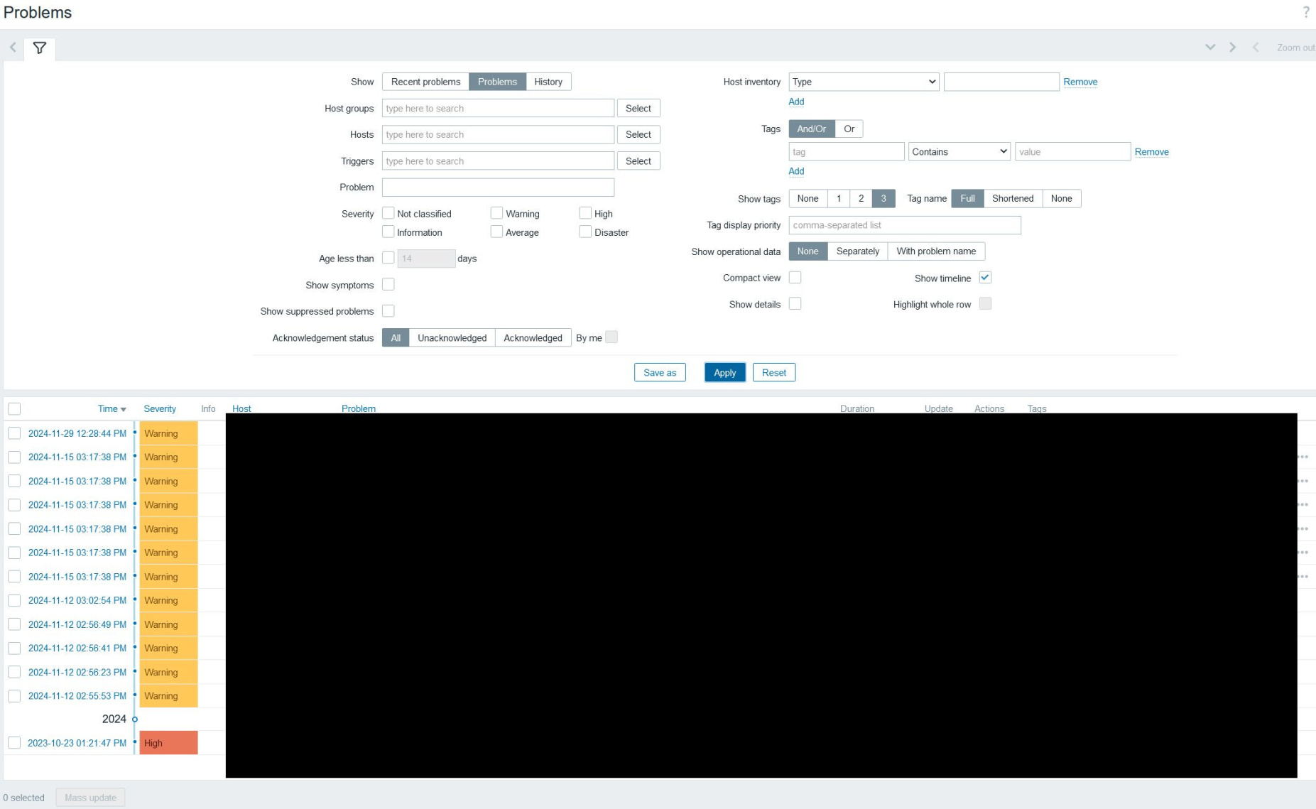

        and what I am getting in the monitorig problems:
        switching to "history" results in empty table.

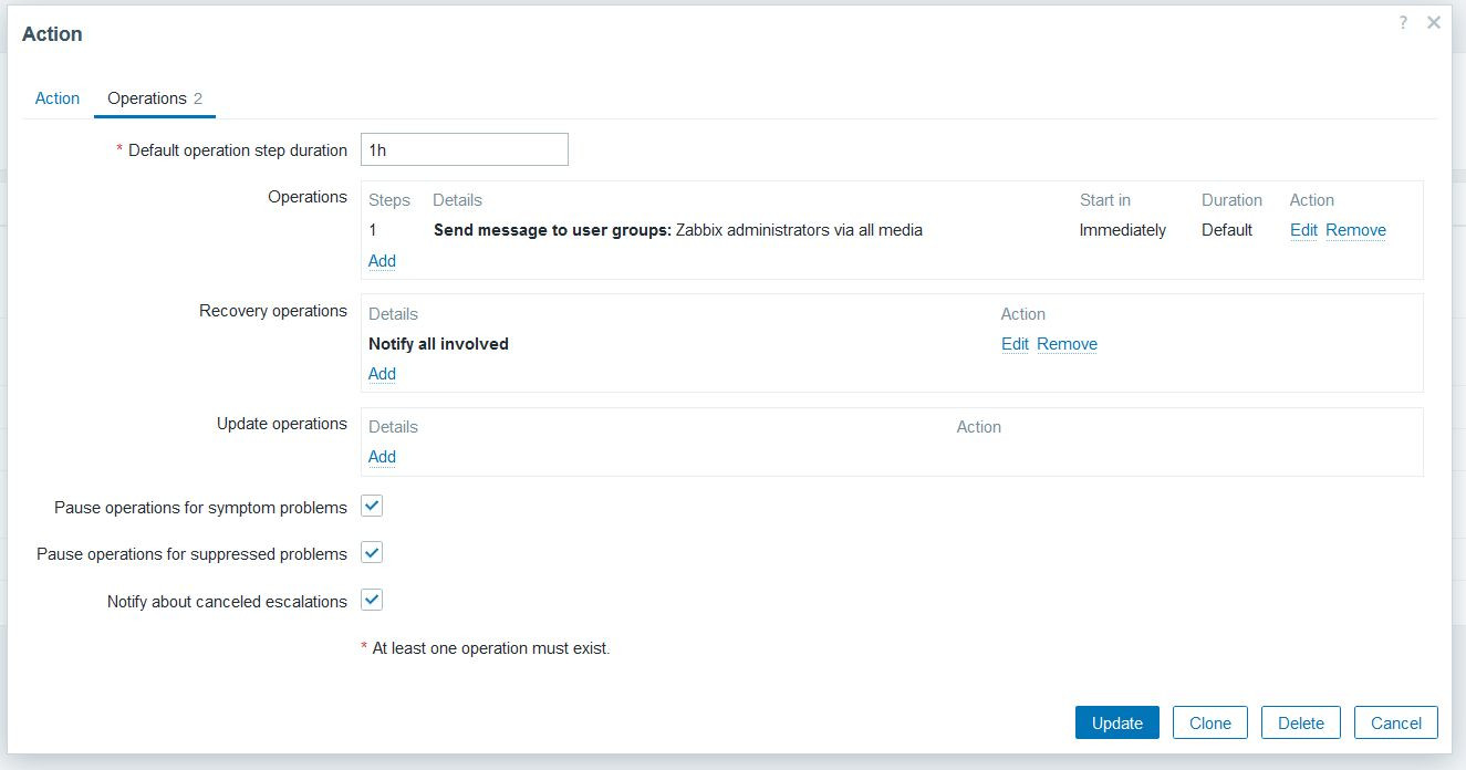

            Under Alerts-Actions-Trigger actions I found something like "Report problems to Zabbix administrators, but if I understand correctly it only sends an email. This is how it is configured:
            Other actions or even if I want to create new, the option is to send a message or run a script.

              • 5004
              If you switch to History, what is selcted here?
              • Kordian
                • Nov 2024
                Eureka!!!
                There is something there and you can click it and there is time filter!!! :-)
                My God, who came up with an idea of hiding it that way!!!
                Thank you cyber, now all of the sudden I can see all the emailed problems.
