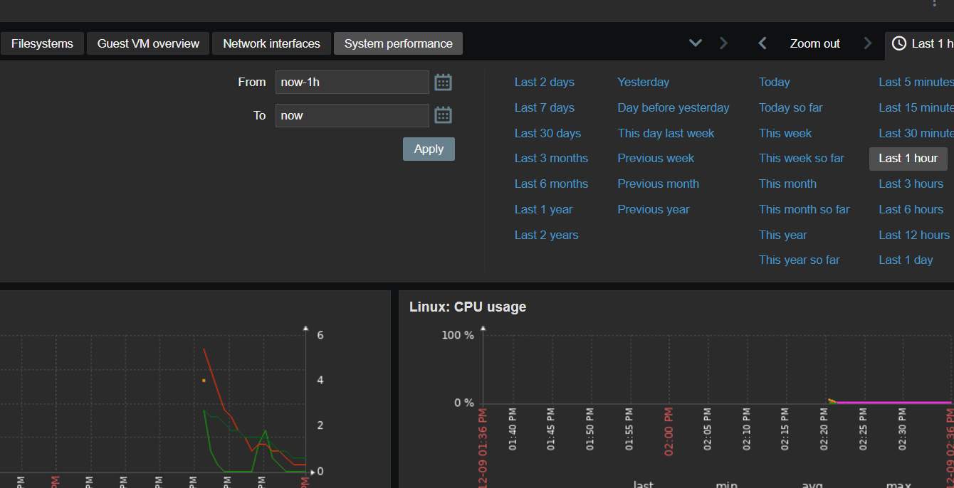

              Its works...Proxy group assigned to vcenter host, on vm installed zabbix agent and configured as active client, assinged Linux active agent template.
