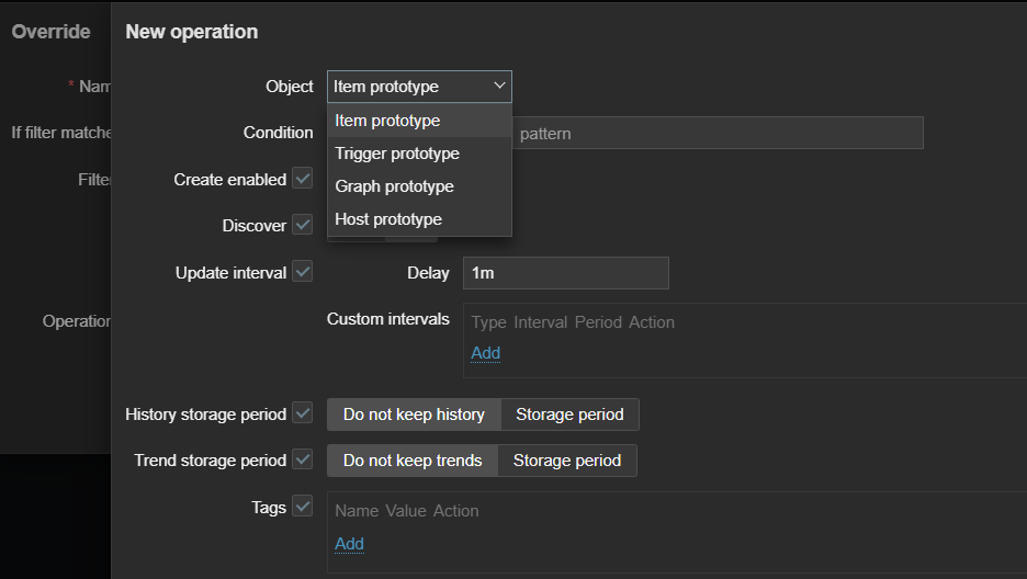

              • 5004
              LLD can generate all triggers in "disabled state".
              Or go even deeper and have overrides based on LLD values..
