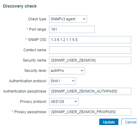

    Snmp settings are done over Macro, so think typo or something else not the problem.

    SNMPv3 Settings:

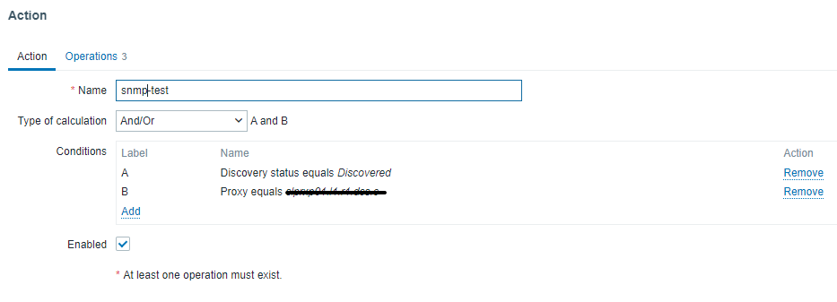

    Acrion:

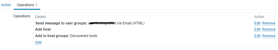

    Operations:

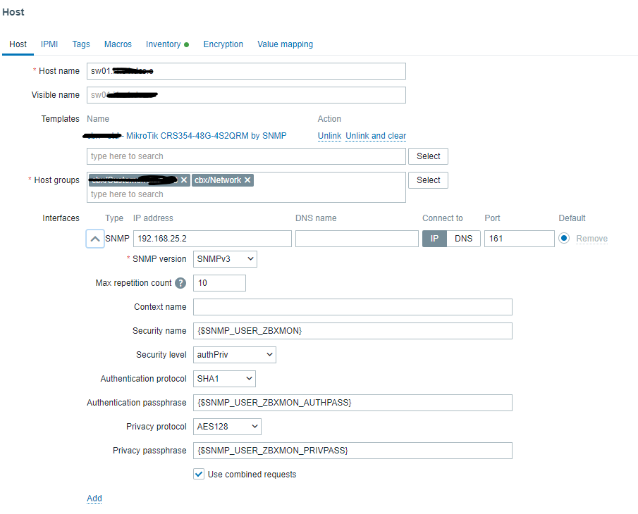

    Manuall added host works as expected (snmp icon = green, data ok)
