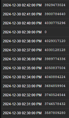

    after installing Zabbix 7.0.3 Solaris Agent, randomly zabbix 7.0.6 server retrieves the available memory as zero as below screenshot

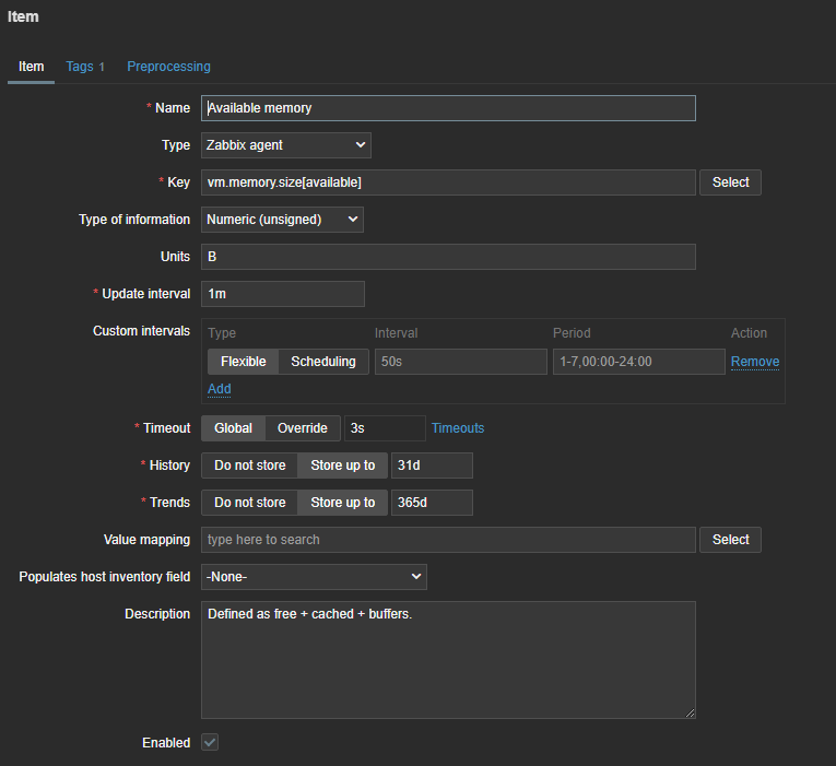

    the standard configuration of the item named "Available memory" is as below screenshot

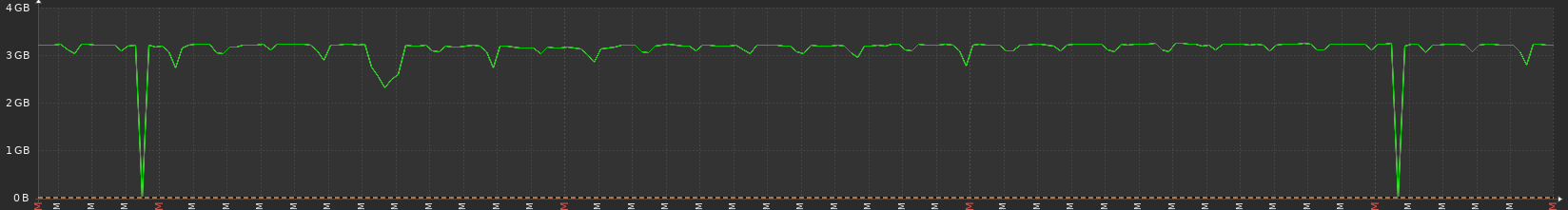

    and this leads to incorrect triggers and graphs as below graph screenshot
    as the graph is drawn with ZERO value due to incorrect item read​s
