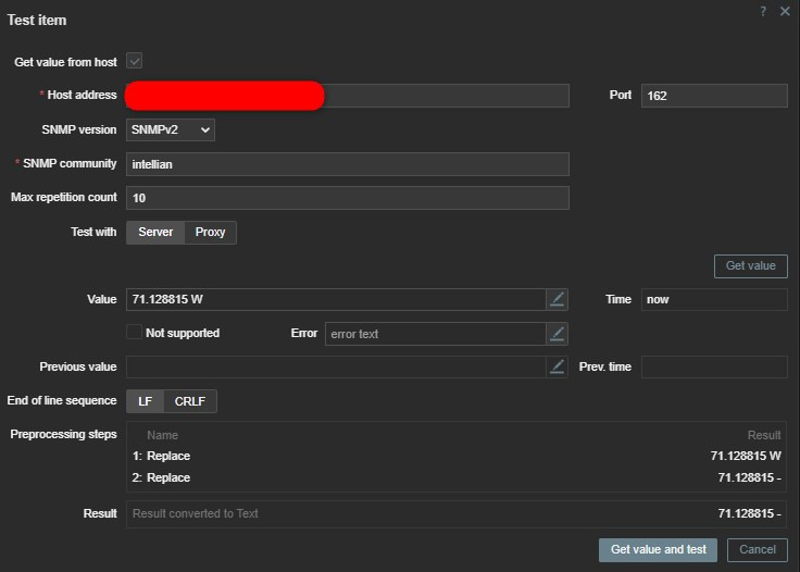

    I have managed to get the GPS from a site, i want to add the GPS to the GEOMAP, but the received GPS has either EAST or WEST at the end, for example 71.128944 W
    I have used reprocessing to replace the W with a -
    But, for GEOMAPs to work properly the - needs to be at the beginning, not the end
    Do you have any ideas please on how to move the - from the end of the result to the start of the result please?

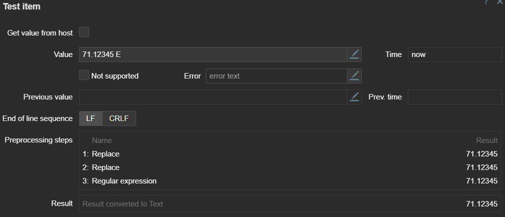

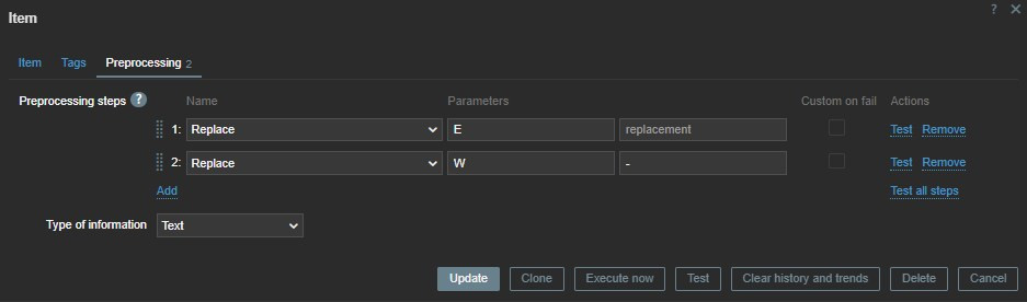

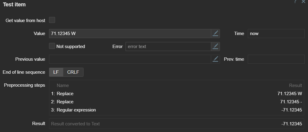

    If you don ot want to do JS preprocessing, then you might get away with this..
