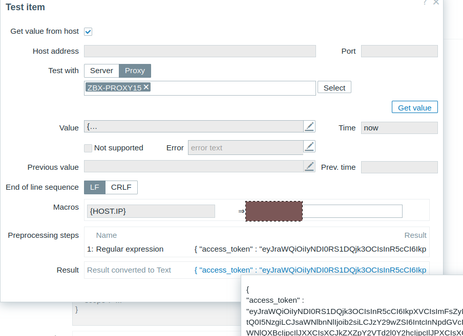

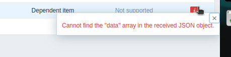

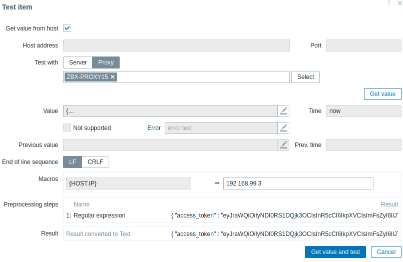

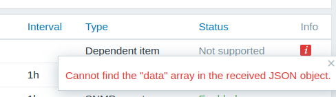

    I'm creating a discovery template for some device. I have an issue which keeps returning "Cannot find the "data" array in the received JSON object"
    All items tests show correct output. Could this be a bug or am i to blame here. Any feedback would be appreciated.

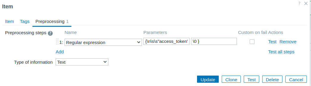

    The template item:
    Click image for larger version  Name:	image.png Views:	0 Size:	104.0 KB ID:	497751

    The confusion i have here is that the error shows "data" but i'm requesting the "access_token" data field.
    For sake i already tried to preprocess replace the access_token to data but this did not help either.
    Many thanks for taking a look at this and provide some feedback

      In essence the item should return a token that i can use as a macro for other items that need Oauth2 authentication. Indeed, the discovery item is a dependent from an item that exists in the template.

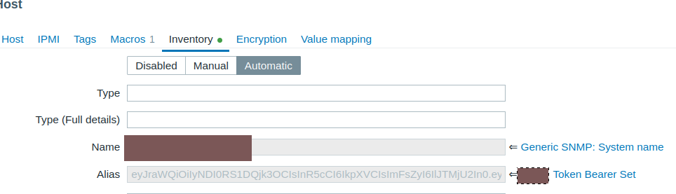

        Maybe worth mentioning. Another way of trying to achieve my goal was to create an item that populates a host inventory field. This works well but this macro {INVENTORY.ALIAS} is not allowed (or does not work) for use in Items.... .

            That is the reason for opening this topic. It does not work when i try to LLD this: it gives me this output:
            thx

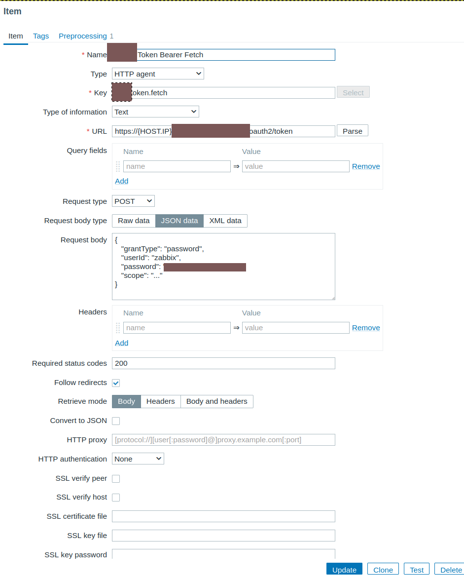

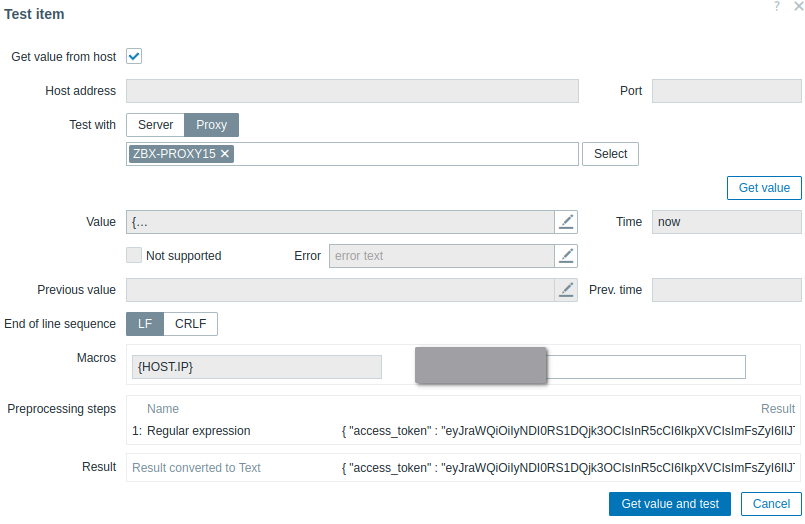

                Master item:
                Name: Token Bearer Fetch
                Type: HTTP agent
                Key: api.token.fetch
                Type: text
                URL: https://{HOST.IP}/management/v1/oauth2/token
                Request Type: POST
                Request Body: JSON data
                "grantType": "password",
                "userId": "zabbix",
                "password": "password",
                "scope": "..."
                Interval 2h
                This works as i receive the info:
                Click image for larger version  Name:	image.png Views:	11 Size:	54.5 KB ID:	497963​

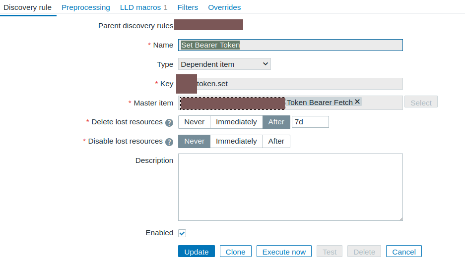

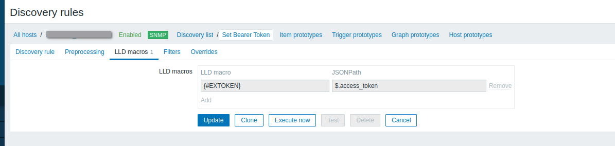

                Discovery rule:
                Name: Set Bearer Token
                Type: Dependant Item
                Key: api.token.set
                Master Item: Token Bearer Fetch
                LLD: {#EXTOKEN} --> $.access_token
                Gives me this:
                Click image for larger version  Name:	image.png Views:	11 Size:	14.7 KB ID:	497964​

                  Oh, so the error is in the discovery rule. Well, this looks like $.access_token isn't extracting the value of the received JSON, you could try:
                  $..access_token
                  but the expression really depends on the format of the received JSON.
