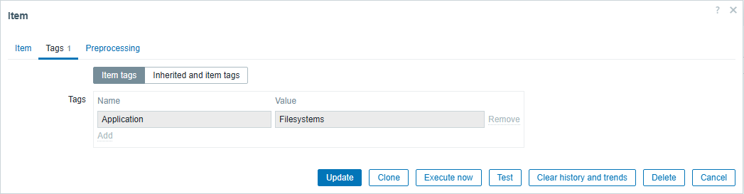

    For a host with these Tags
    according to the docs https://www.zabbix.com/documentation...rence/item/get why not use the "tags" parameter? So the request should be

    for the Tags from the example above. For me this returns the right results (Zabbix 7.2).
    P.S. The "params" parameter should be an JSON object ( { ... } ) and not an array ( [ ... ] ). And I have ommited the "auth" parameter, because Zabbix 7.2 doesn't support this parameter anymore.
