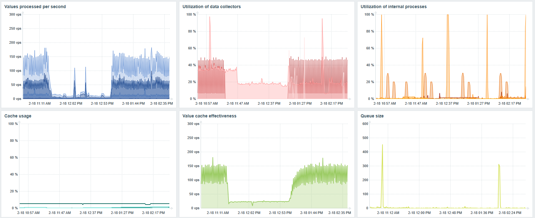

- Based on the graph Zabbix host isn't overloaded, the ICMP poolers are at 50%, unless I'm missing something, and the number of API calls causes a bottleneck somewhere else. (below)

- Below housekeeper process jumps to 100% from time to time.
- CPU stays at avg 15%, mem at avg. 35%. (4vcpu, 16GiB mem)
- Zabbix uses 41k items, 11k triggers
