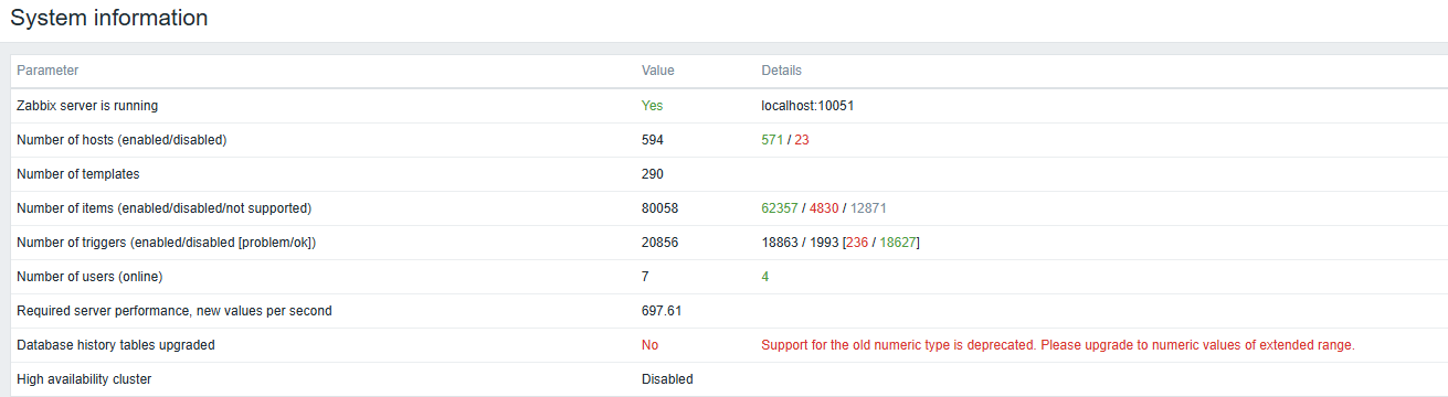

    I'm running Zabbix 6.4.4 with MariaDB. A few months ago I was constantly hitting the housekeeper process over 75% which was solved by partitioning tables.
    I now have another problem which I cannot find an easy answer for online, as per subject. Some have suggested that the issue could be with the database itself. I would appreciate any suggestions.. I am not a DBA however I can do some basic tasks
    I did notice that the process dies completely by midnight, and starts picking up again 3 hours later. Is there any way I can know what is causing this?

    You can try to increase StartDBSyncers, but judging by the documentation, it is not recommended to abuse this.
    Most likely, the disk's speed capabilities are exhausted here.
    how about innodb_flush_log_at_trx_commit = 0 ?
    sync_binlog=0 ?
    Of course, you should first read about these settings in the mysql documentation.

          Hello I increased the StartDBSyncers to 12 from the default setting of 4, and it solved the issue for me. Given that the maximum is 100, I guess this is not a drastic change. Thank you!

              Shared storage over fiber channel, 10k HDD drives
              This is not very fast considering the current fashion for SSDs. Isn't it ?
              I'm afraid this setting is some kind of insanity limiter, but not a designed maximum.
              It's good that it helps in your situation, but most likely due to the displacement of other storage users.
              I see that you haven't made any other settings, but there are some that are almost always worth doing.
              Try increasing innodb_buffer_pool_size anyway .We don't know how much, but start with at least 2 GB
              This is also an important setting that I would recommend without any concerns:
              innodb_flush_log_at_trx_commit =2

                Agree HDDs are now way behind now on speed... will push to get it on SSDs
                Will also carry out the changes you recommended, and monitor how it goes. Much appreciated.
                • Sven Kodali
                  • May 2023
                  • 20
                  Just to update on the DB settings
                  innodb_flush_log_at_trx_commit =2 was there already
                  I increased the buffer to 2GB, and the history syncer went from hovering between 40 - 60% to a complete flatline below 1%. Massive difference!
