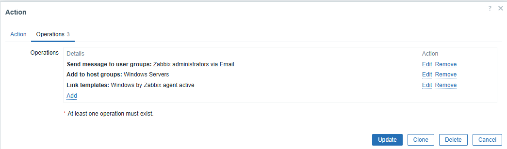

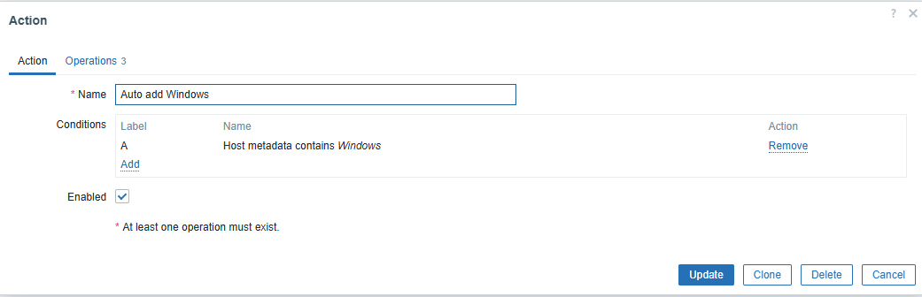

    • belfert
      • Jan 2018
      I have several auto registration actions configured the same as on my 4.0x system. Email is configured.
      • belfert
        • Jan 2018
        This is fixed. I switched to using HostMetadataItem instead of HostMetadata in the config file.
