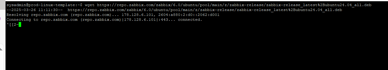

    Hello, I have problem install zabbix agent package.
    First, I was trying below command
    wget https://repo.zabbix.com/zabbix/6.0/u...u24.04_all.deb
    Result is -
    --2025-03-26 11:11:30-- https://repo.zabbix.com/zabbix/6.0/u...u24.04_all.deb
    Resolving repo.zabbix.com (repo.zabbix.com)... 178.128.6.101, 2604:a880:2:d0::2062:d001
    Connecting to repo.zabbix.com (repo.zabbix.com)|178.128.6.101|:443... connected.
    ^[[2~OpenSSL: error:0A000126:SSL routines::unexpected eof while reading
    Unable to establish SSL connection.
    Second, I was trying the manual install .deb and the error is same

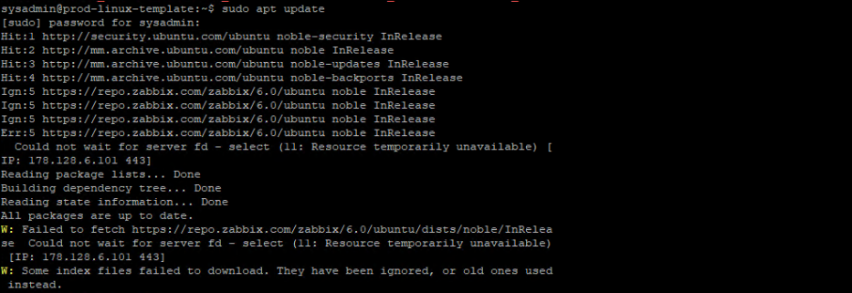

    sudo apt update
    sudo dpkg -i zabbix-release_6.0-6+ubuntu24.04_all.deb
    sudo apt update
    Result is
    sudo apt update
    [sudo] password for sysadmin:
    Hit:1 http://security.ubuntu.com/ubuntu noble-security InRelease
    Hit:2 http://mm.archive.ubuntu.com/ubuntu noble InRelease
    Hit:3 http://mm.archive.ubuntu.com/ubuntu noble-updates InRelease
    Hit:4 http://mm.archive.ubuntu.com/ubuntu noble-backports InRelease
    Ign:5 https://repo.zabbix.com/zabbix/6.0/ubuntu noble InRelease
    Err:5 https://repo.zabbix.com/zabbix/6.0/ubuntu noble InRelease
    Could not wait for server fd - select (11: Resource temporarily unavailable) [ IP: 178.128.6.101 443]
    Reading package lists... Done
    Building dependency tree... Done
    Reading state information... Done
    All packages are up to date.
    W: Failed to fetch https://repo.zabbix.com/zabbix/6.0/u.../noble/InRelea se Could not wait for server fd - select (11: Resource temporarily unavailable) [IP: 178.128.6.101 443]
    W: Some index files failed to download. They have been ignored, or old ones used instead.
    Please help me how to solve this problem , my internet is proper work but i can't install zabbix agent on Ubuntu Server.
