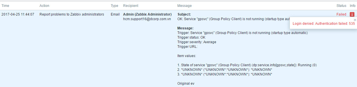

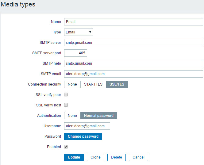

    Hello!
    When I tried to configure Gmail account in User Media and test by firing a trigger, it was indeed blocked, but Google then sent an email about how they case about my security.
    They offer to follow this instruction to lighten the security policies a little: https://support.google.com/accounts/.../6010255?hl=en

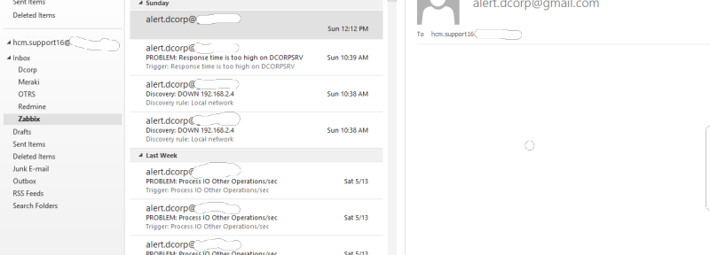

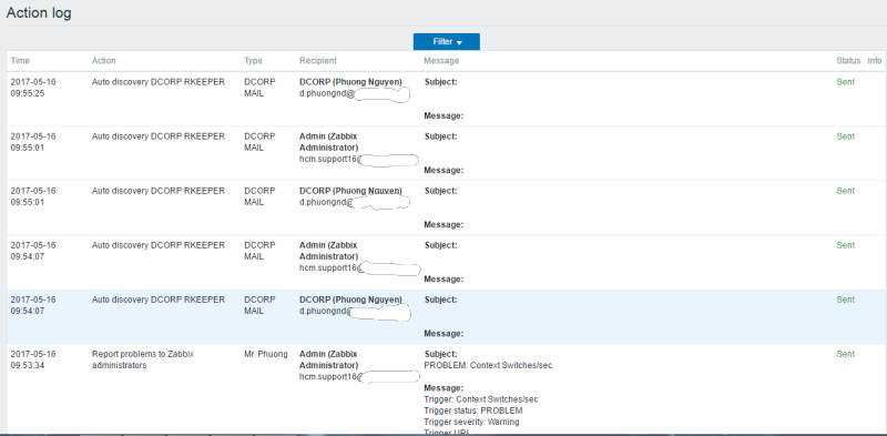

      Issue about sent mail
      Hi Support,
      The process "Media types" running normal but i don't receive anymore email.
      Check "Action log" notification is everything normal.
      So what's this problem happend in my system? Please help me check this issue above
      Phuong
