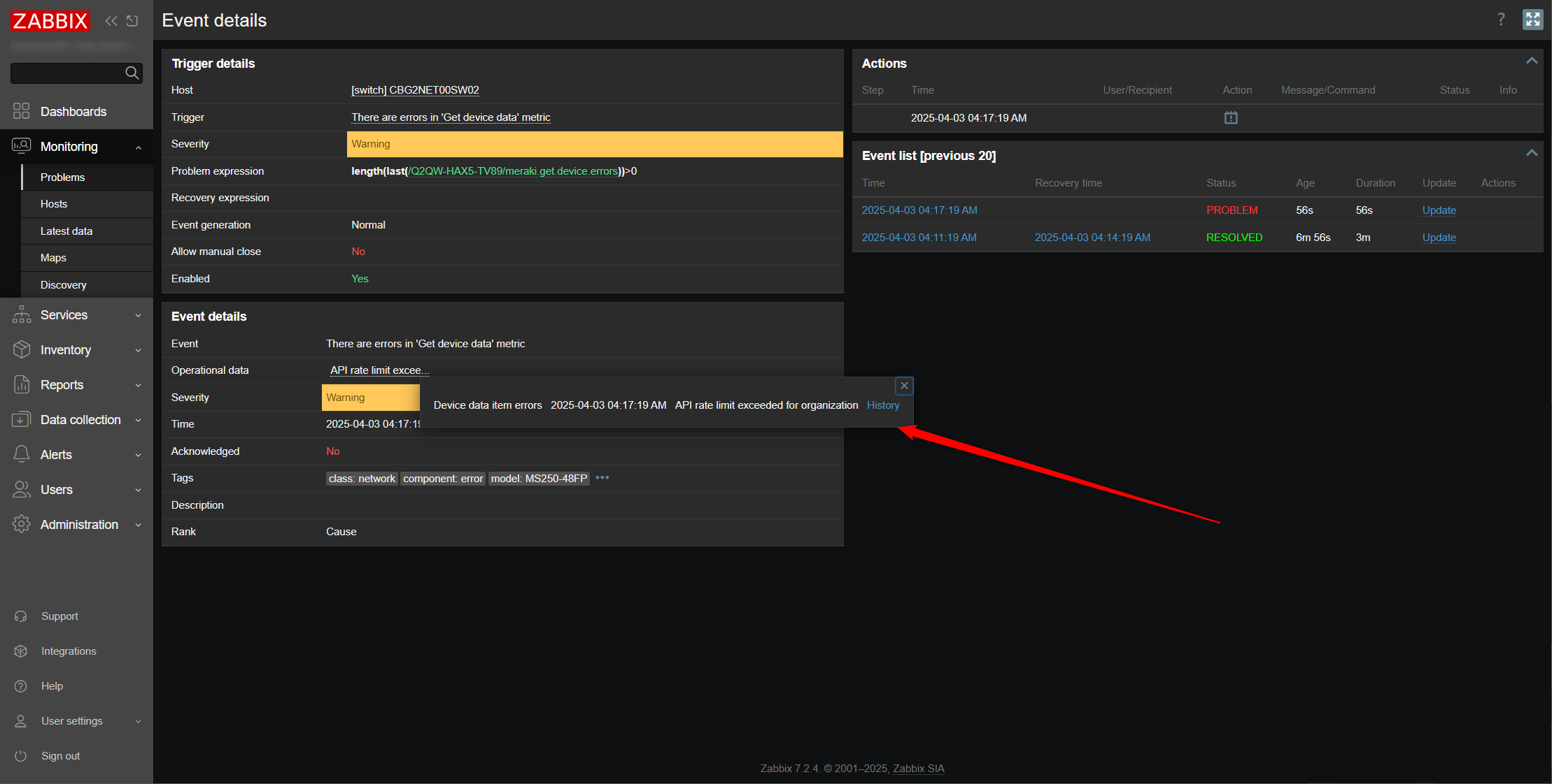

    We have a large Meraki infrastructure, and are trying to monitor using the official Cisco Meraki dashboard by HTTP template.
    Unfortunately, it does not work very well. The template is not honoring the API rate limit (https://developer.cisco.com/meraki/api-v1/rate-limit/) and floods the API with queries, resulting in transient errors for every device similar to the one shown below.
    We recently upgraded from 7.0.4 to 7.2.4, and hoped the issues had been fixed in the newer version but sadly not.
    Does anyone have a solution for this?
