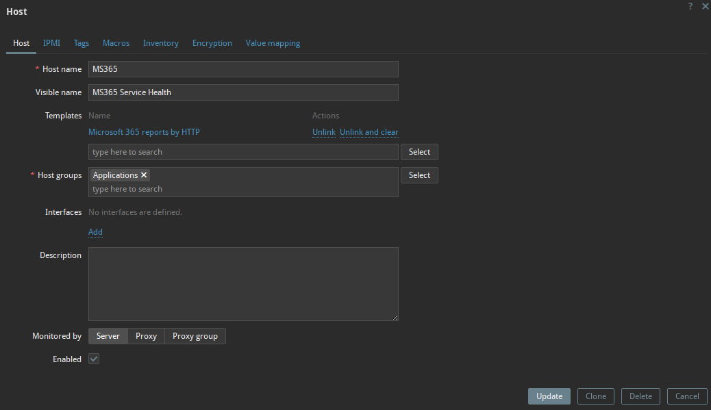

    I followed the integration guide, at https://www.zabbix.com/integrations/ms365, as best as I could. Unfortunately, the document didn't give any examples of how to have it display the info in the dashboard so I took how someone did it from another post. Essentially, I created a host, set the template to Microsoft 365 reports by HTTP, and used "Applications" as the host group (since I hadn't created a Host group specifically for RESTful service statuses prior to starting work on integrating MS365 service health reporting into my dashboard). Here's a screenshot of host's properties
    <See attached Image 1>

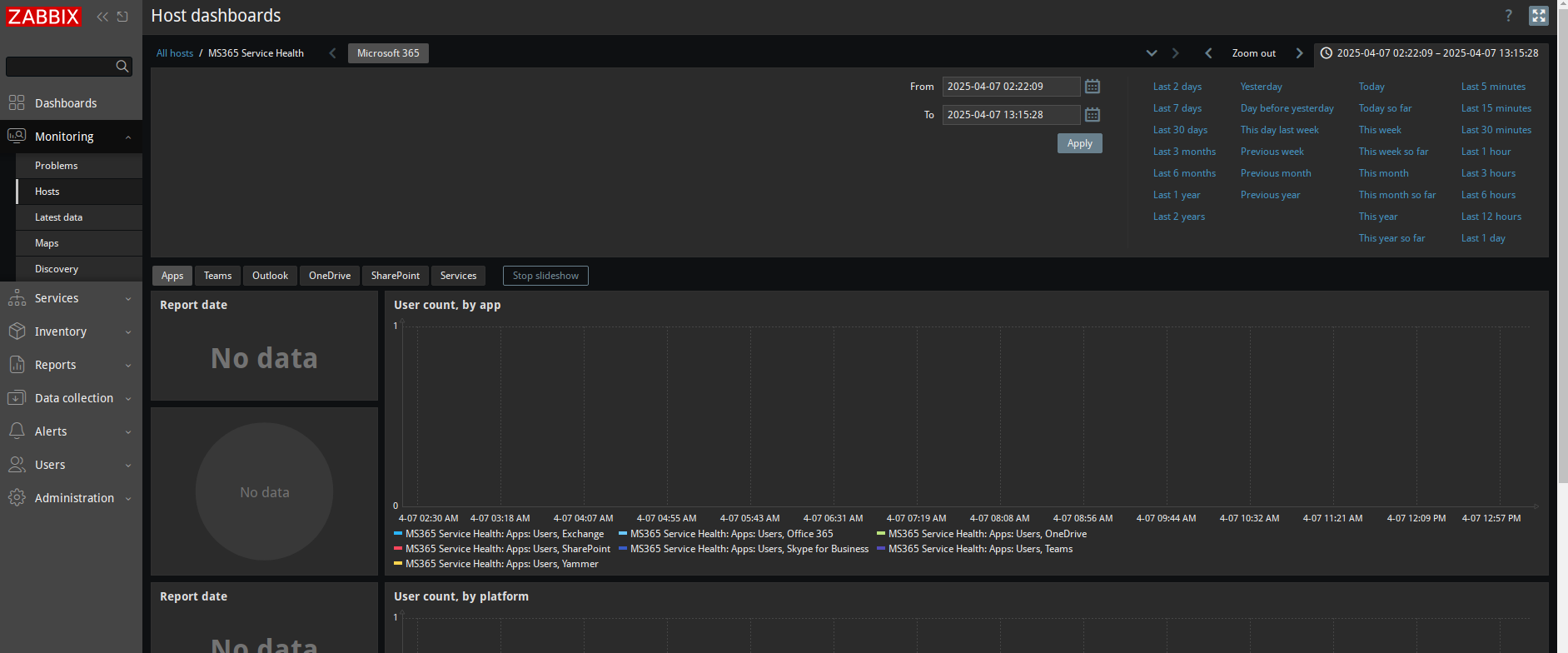

    The problem, is when I go to the Dashboard, located here:
    <See attached Image 2>
    I get this symptom (of whatever the cause of the issue is):
    <See attached Image 3>

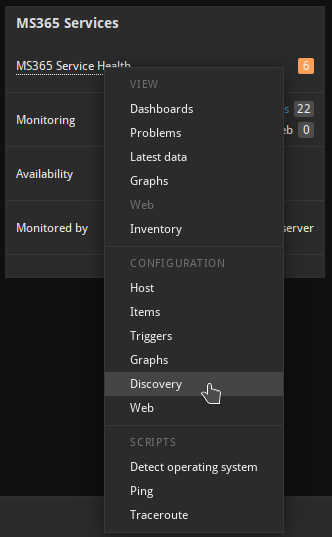

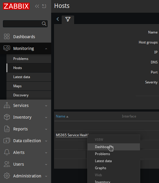

    There's six problems that keep coming up that I think is I'm getting 6 problems that keep coming up. They may not be connected, but I'm inclined to believe they are. The problem listed by Zabbix is "Microsoft 365: Apps: There are errors in requests to API". If I go back to my dashboard, and click on the "MS365 Service Health link in the MS365 Services titled Host card widget located here:
    <See attached Image 4>
    and then the Discovery option. I come to the Discovery rules screen that that host is using.

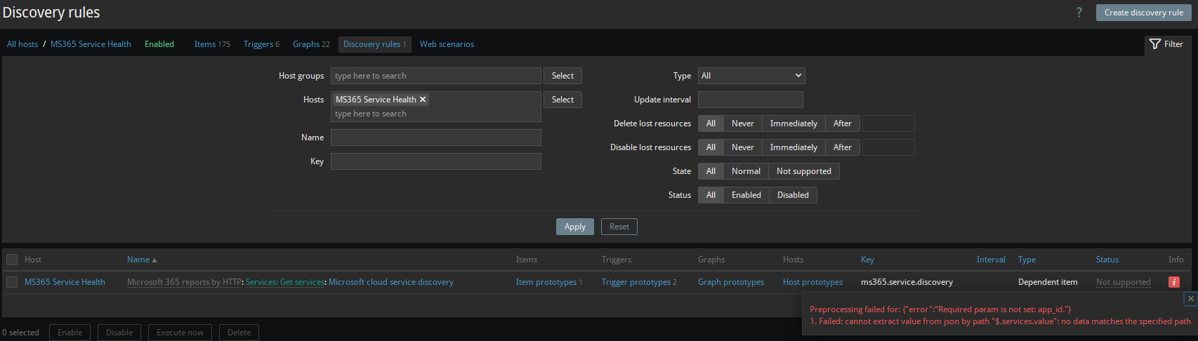

    if I click the icon (white "i" on a red'ish background) under the Info column
    <See attached Image 5>
    I finally get more details on the error which says:
    "Preprocessing failed for: {"error":"Required param is not set: app_id."}
    1, Failed: cannot extract value from json by path "$.services.value": no data matches the specified path
    Looking further at the template guide, towards the bottom, under the section: LLD rule Microsoft cloud service discovery
    It references the JSON path $.services.value. As a result, I'm guessing the error is tied somewhere to that part of the template. However, I don't know if it's something I mis-configured, didn't configured, or there's some bug in the template. Any help would greatly be appreciated!

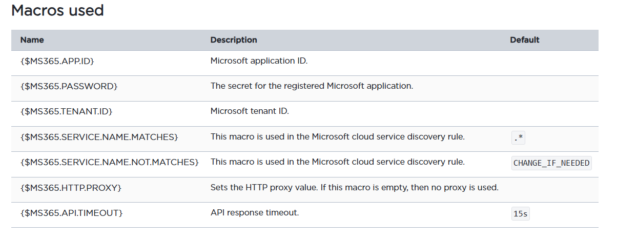

    It says "Required parameter not set: app_id" ... DId you fill all the macros with required values ? https://git.zabbix.com/projects/ZBX/...ease%2F7.2#594
    Click image for larger version  Name:	image.png Views:	0 Size:	70.6 KB ID:	501615
