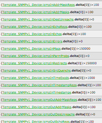

        Hello and thanks. I'm not so concerned about the makeup of the expression. As you can see delta(0) is used frequently with all these triggers (see attached).
        What I'd like to know is (in increasing importance): why did it initially work, why did it stop working, and what can I do to get it working again?

          I guess your screenshot from Zabbix 2.*, may be 2.0.
          In this version (0) is the same as (#1). But in Zabbix 3.* function delta(0) is wrong.

            We are bound to Zabbix 2.4 as the OS is bound to RHEL 6.8. There are other applications we must support here.
            What we'd really like to know is why the template no longer links. Can anyone assist with that issue?
