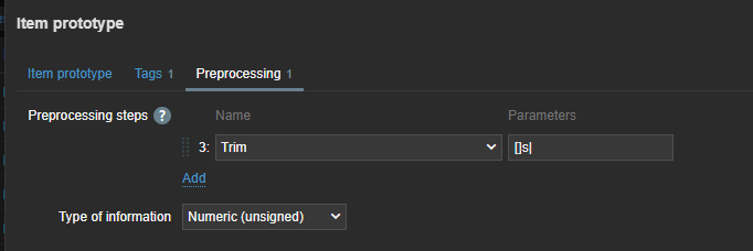

    Originally posted by bbonno
    If the returned 'value' is [s|1], then a simple preprocessing step like this will fix your issue. This will remove those characters from your data, and only leave the number.
    []s|

    • bbonno
      • Apr 2025
      • 24
      []s|

        • 5002
        []s|
        well, it is not exactly that easy.. "[s|1] " you can see, when testing the item (zabbix_agent2 -t item).
        I think you can ignore it and just set your item typ as you need...
        I tested with some random items, it is either "s" there, or "-" if there was no data .. "[-|ZBX_NODATA]". Everything else produced "s".
        It seems to be agent2 related thing.. if you test with classic agent, you will get some other options also... u,t,d etc...
        • bbonno
          • Apr 2025
          • 24
          It's been a while since I set up a Userparameter, and I don't think I've ever tested one from the command line like that. Running the agent like that, mine return [s|"actual Data"], but I have zero accommodations in my items for this, so I don't think any of these extra characters are sent to the Zabbix server/poxy.
