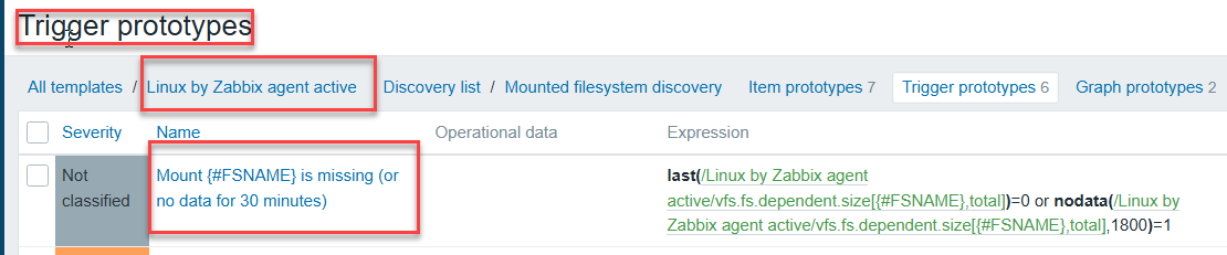

              I don't know if it makes a difference or not, but it's a trigger prototype. We're using Zabbix 7.0 LTS and the trigger is under "Linux by Zabbix agent active." I'm fairly certain this isn't something we added.

                As Cyber said, the trigger you display is not present on the default "Linux by Zabbix Agent active" template.
                It appears that your template has been customized.
                The trigger expression is simple: it checks if the latest value for the total filesystem size is zero, or if no data has been received in the last 30 minutes, as the name suggests.
                The "Get filesystems" item is the master item that actually collects all data. You can "test" the item to see all the raw data retrieved.
                From what I have gathered so far, this trigger should only evaluate the discovered filesystem. If you are receiving alerts for the "local" FS, check your hosts' mounts.
