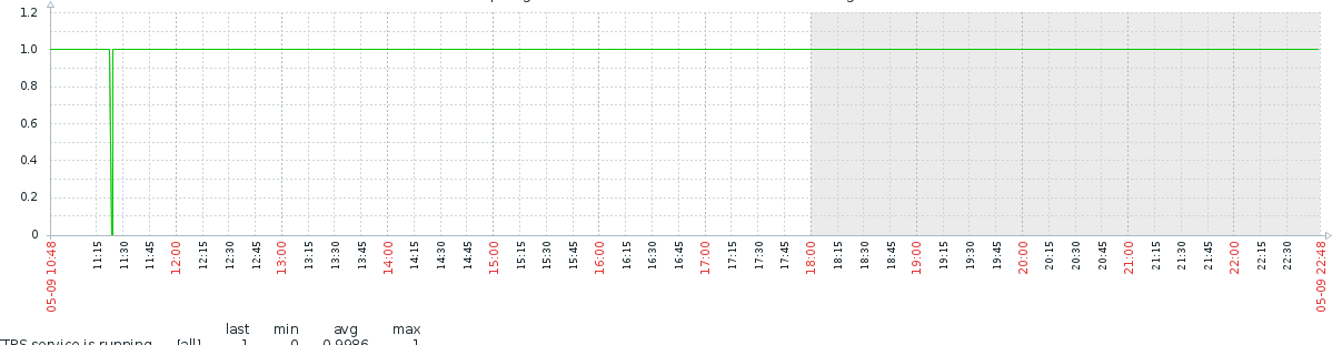

    A screenshot of the up/down state over the past 12 hours from the problematic server:
    VS the other

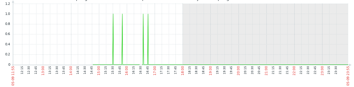

    for further testing, I have a Web Scenario setup to montior the site, which does NOT fire the false alerts. This is only setup on the problematic server:
    (the blips at the beggining where me testing)
