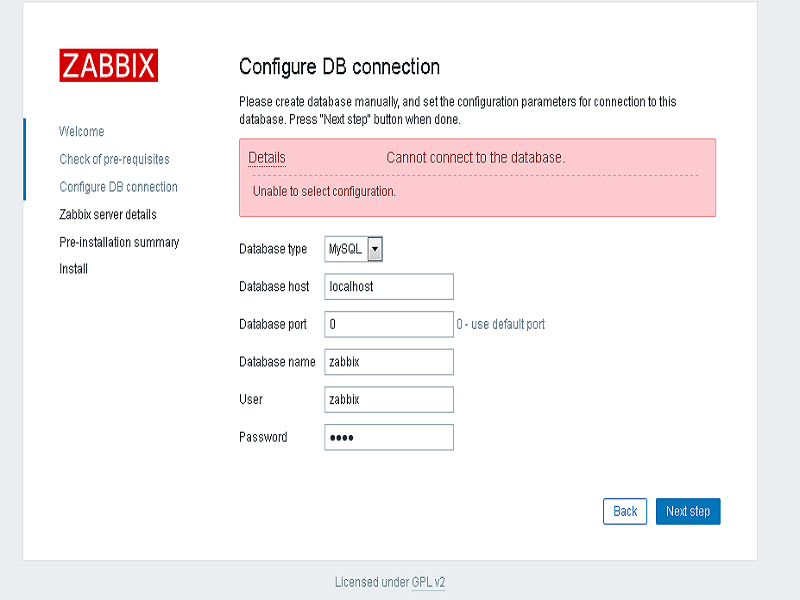

    Hey, I'm new to zabbix & was installing it on ubuntu 17. I've tried everything but it keeps giving me the error
    Database is mysql
    also have phpmyadmin
    &php7.0 installed along with all required packages
    Cannot connect to the database.
    Details Unable to select configuration.
    Can anybody help

    Can you manually connect to the DB with those details from the server?
    mysql -uzabbix -p zabbix
    And then enter password

      Send zabbix_server configuration file for this setup
      GUI database details like DBName, DBPassword, DBUser should match zabbix_server configuration file then only it can connect to database.
      So, please send above parameters from configuration files

        I think that the database for Zabbix was created, did you load the initial data?
        $ mysql -uroot -p
        mysql> create database zabbix character set utf8 collate utf8_bin;
        mysql> grant all privileges on zabbix.* to zabbix@localhost identified by '<your-password>' ;
        mysql> exit
        $ cd <source-files>
        $ cd database/mysql/
        $ mysql -uroot -p zabbix < schema.sql
        $ mysql -uroot -p zabbix < images.sql
        $ mysql -uroot -p zabbix < data.sql

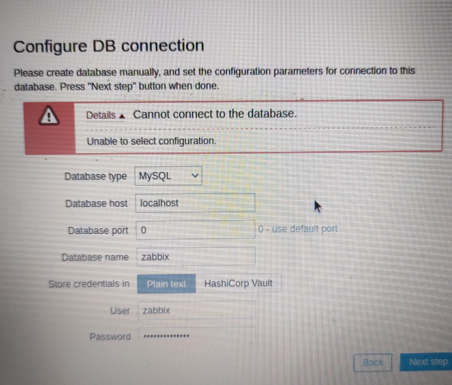

          Have the same error, Cannot connect to database Unable to select Configuration...

            Hi surajhiremath,
            What OS and what version did you install Zabbix on? And which Zabbix version did you install? And did that method install using a package? What database do you use?
            If you can't select the DBMS you want to use in the Web Frontend Setup Wizard, you don't have the PHP modules installed to access that DBMS. Install the module according to your environment.

              Hi Atsushi, I used Ubuntu OS 20.4 version for zabbix 5.4 installation. I used MySQL database packages. I followed the steps mentioned in below link -https://www.zabbix.com/download?zabbix=5.4&os_distribution=ubuntu&os_vers ion=20.04_focal&db=mysql&ws=apache.
              I am not sure which PHP modules to install.. Could you please help ?? Perhaps share a link for it

            Have installed PHP 7.4 but the problem still persists. Please check the attached file for error

              I think the error occurs when a table called config doesn't exist in the database or you can't get the value from the table. Did you input the initial data after creating the database? Does the user you are using to access have access to the table?

            I do not have an IT background and I followed the steps mentioned by this youtuber who successfully installed Zabbix. (https://www.youtube.com/watch?v=r1RMRVVxoxU). He did not input any initial data (not atleast in the video)..
            So I am not sure why this error appears..
