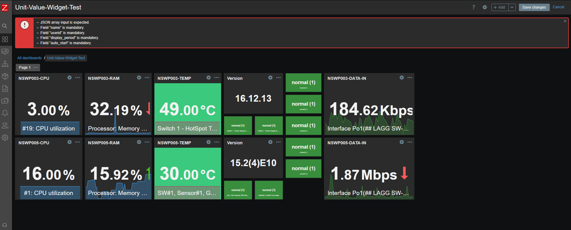

    I have a problem with my dashboard.
    Whenever I add a single item value widget to the Global View or too many of these widgets to a custom dashboard, I get the following error:
    JSON array input is expected.
    Field "name" is mandatory.
    Field "userid" is mandatory.
    Field "display_period" is mandatory.
    Field "auto_start" is mandatory.
    I run zabbix (vm with 4 cpu cores and 8GB ram) on a current AlmaLinux 9.5 with
    zabbix-server 7.2.6
    mariadb 11.4
    nginx 1.25
    php-fpm 8.0.30
    SELinux is in permissive mode
    Is this a known bug? Is there a solution for this or is here a limitation to this specific widget that I'm unaware of?
    I already raised the memory_limit as mentioned in another post, but that didn't help.
    See attached image below:
    (I can save this dashboard if I delete any of the widgets there, so I seem to hit some kind of limitation)

          Just as an addition, I set up another test instance with RockyLinux 9.5, PostgreSQL 17, Apache2 2.4.62 and Zabbix 7.2.6 with the same result.
          I hit a limit at 18-20 unit value widgets.
