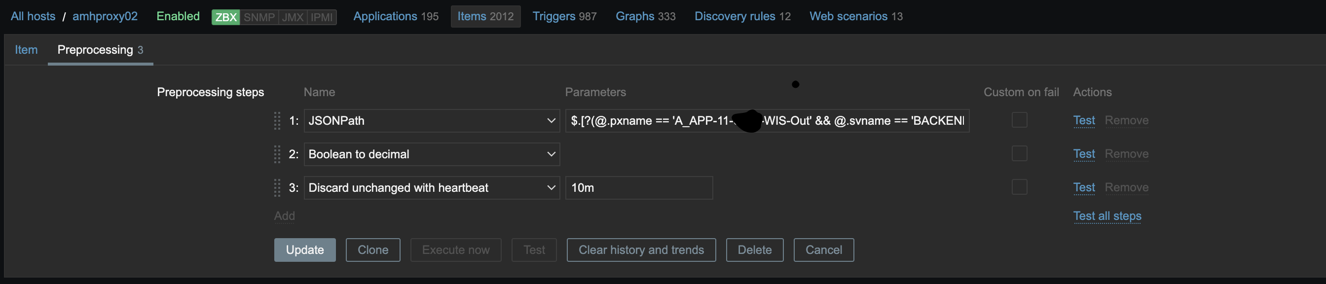

    Trigger should initiate once 5 checks have been performed where the server is down. The check is decided by the parent which is HAProxy by HTTP
    The preprocessing step looks like this:

    If you remove "discard unchanged" you will get that thing triggered in five minutes. If you leave that in place and change trigger to fire after 2 fails instead of 5, it will inform you in 10 minutes instead of 40...
      • 5004
      "Discard unchanged with hearbeat" -> 10 minutes...
      First fail ... 10m break... second fail.. 10m break... .third failure.. 10m break... fourth failure ... 10m break... fifth failure... lets count now those 10m breaks... 4 of them... 40 minutes...

          • 5004
          failure as a failed check... I assume check is performed with 1m interval... at one moment it fails, records it, then keeps cehcking, finds things failed, but as "discard unchanged" is involved, it gets recorded again only after 10 minutes... as you say "Trigger should initiate once 5 checks have been performed where the server is down" then it takes a while to gather those 5 recorded failures...
              • maherenthusiast
                • May 2025
                Thank you for your help. We have changed this and now the problem gets created as expected. We are still unable to explain why this worked in the past but now does not seem to work as the template was created. But we're happy as things are now.
