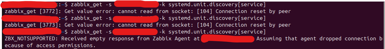

      Thanks for the reply, I checked within the log files of the corp servers and it seems the reporting is working, no errors, if I trigger it manually I can see the JSON. It seems the actual sending of the JSON isn't working.
      Locally this works on the agents "zabbix_agent2 -t "systemd.unit.discovery[service]" and reports back the list of services.
      When I try to trigger the agents remotely I receive "zabbix_get [3772]: Get value error: cannot read from socket: [104] Connection reset by peer"
      When I try I aim it towards the server, I know this is not how zabbix _get functions but maybe give more information, I get "ZBX_NOTSUPPORTED: Received empty response from Zabbix Agent at [x.x.x.x]. Assuming that agent dropped connection because of access permissions."
      I've tested the firewalls on both the agents and server and everything is open and works.

  • FromDaMud
    • Jun 2025
    First two are aimed at the different agents and the last one was aimed at the zabbix server, I know it's typically not set up like that but just thought the last entry may give a hint.
