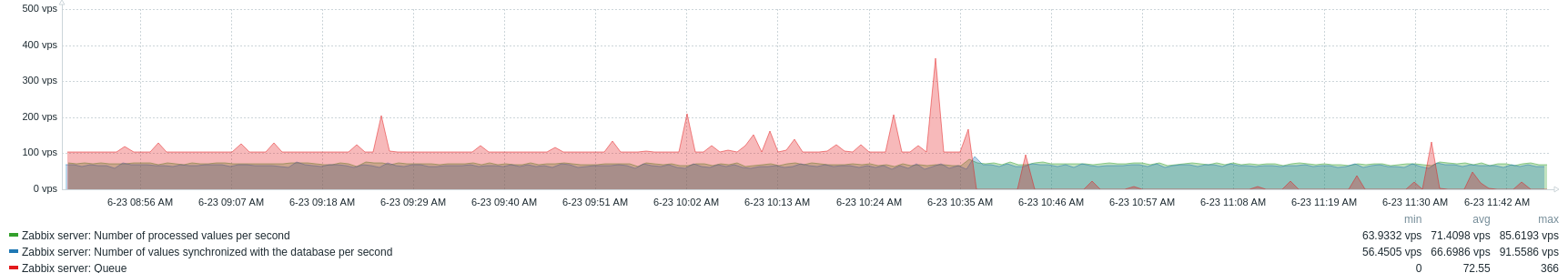

      Here some graphs/values showing the problems
      Zabbix server: Utilization of preprocessing manager internal processes, in %: 99.109 %
      Preprocessing queue 0 (before) now growing to 368
      Discovery queue 0 (before) now growing to 750
      server: Queue => constant at 105 (before some spikes)
      Calculation process at 99%

          This morning check indicate a problem, the queue problem seams to be related to a windows Hyperv system
          " Zabbix server: More than 100 items have been missing data for over 10 minutes" and i have graphs indicate queue problem too
          Click image for larger version  Name:	update7.0.14-server-performance.png Views:	0 Size:	118.1 KB ID:	504281
