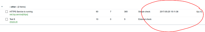

        But still no data received. Ald also the "last check" stays empty as you can see in attachment.

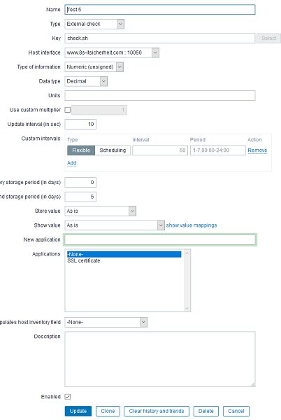

                What about your item configuration (especially 'Type of information')? Please make a screen of that.
                Also, in your host you should see an error beside your external check item (Configuration - Hosts - host - items).

                    Please see attached screenshots from host configuration and item list as mentioned.
                    What I really do not understand:
                    I really looks like Zabbix does not get any results back from the script nor does it show any date in 'last checked' (latest data). It really seems to ignore my settings. But the check.sh script is being executed as my log file shows...
                    And I do not find any errors as mentioned. Neither in Zabbix Server Log nor in the Zabbix frontend. I'd expect at least an error regarding wrong type of data returned in the value or something.
