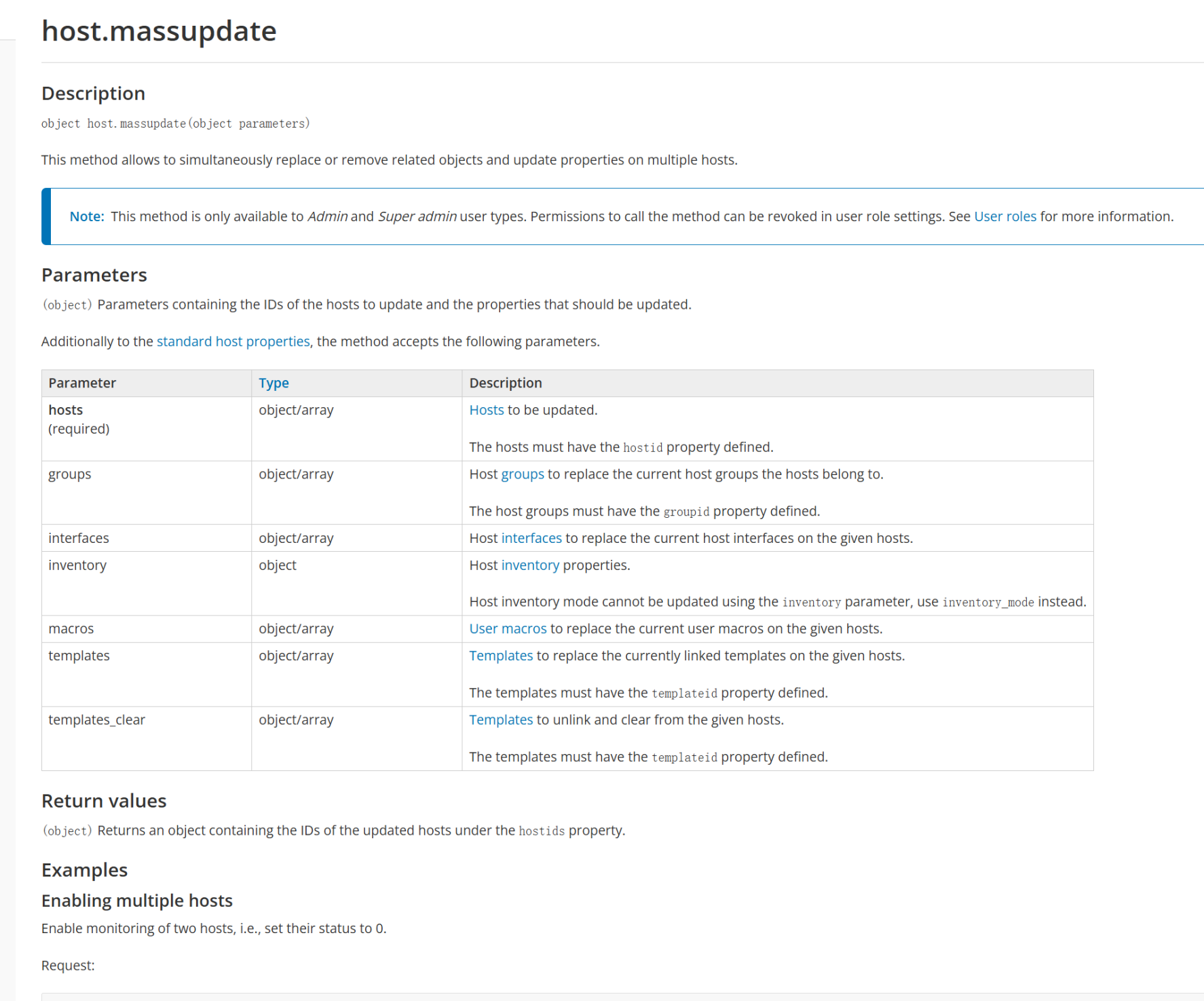

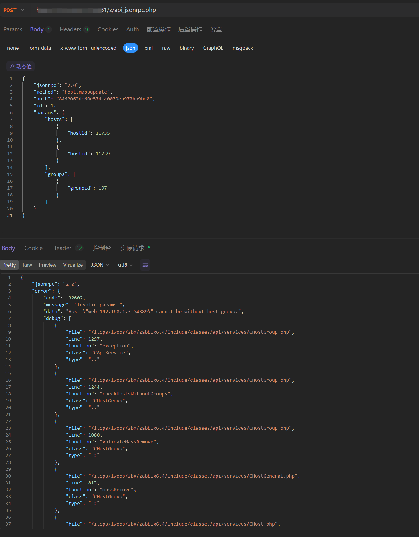

    I used API [host.massupdate] to update my host groups in batches, and the following exception appearedClick image for larger version

    There is a group[179] on my host [11735], and there is no group[179] on my host [11739]
    I need to replace the group [179] in batches.
    Is the API not supported, or I wrote it incorrectly, or there is a problem with it​
