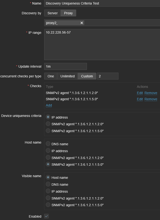

    Recently, I noticed that when we have an SNMP discovery rule and one of the OID values is "uniqueness criteria", the other OID is no longer discovered.
    For example:
    A discovery rule queries the OIDs ".1.3.6.1.2.1.1.2.0" (object id) and ".1.3.6.1.2.1.1.5.0" (hostname).
    Click image for larger version  Name:	discovery_rule.png Views:	0 Size:	46.7 KB ID:	505527

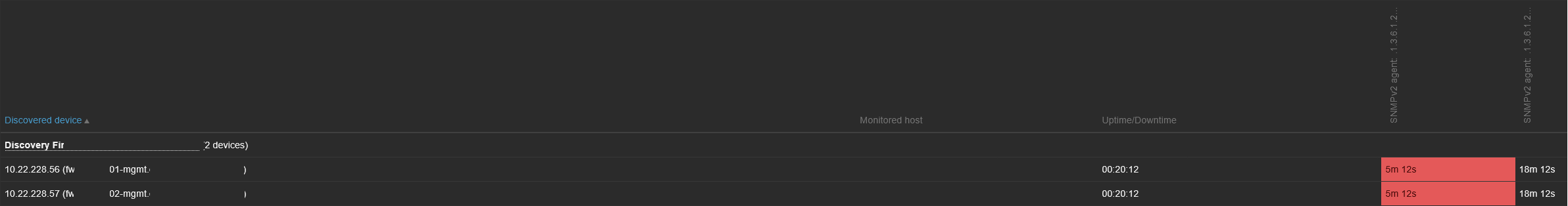

    Two devices are found, and both SNMP "services" are discovered.
    Click image for larger version  Name:	discovered_devices.png Views:	0 Size:	16.4 KB ID:	505528

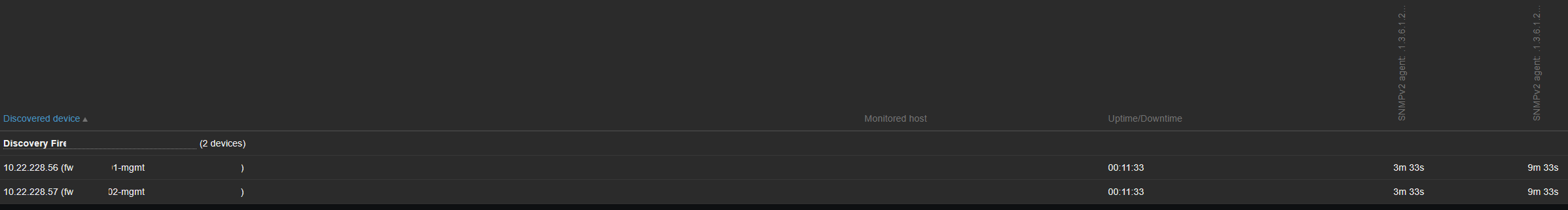

    When the "uniqueness criteria" is set to ".1.3.6.1.2.1.1.5.0", however, the first OID (object id) is then not discovered anymore.
    Click image for larger version  Name:	discovered_fail.png Views:	0 Size:	17.1 KB ID:	505529​
