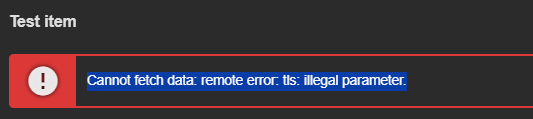

starting from some days ago, which could coincide with zabbix agent upgrade to 7.0.17, I started to get this error on a item using zabbix agent and "web.certificate.get" when trying to get SSL certificate details from a site.

2025/08/22 07:54:42.052083 failed to execute direct exporter task for key 'web.certificate.get[[mysite]]' error: 'Cannot fetch data: remote error: tls: illegal parameter.'
