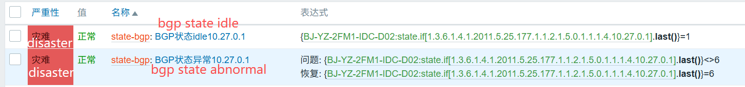

    We are using Zabbix 4.2.8 to monitor our Huawei CE8860EI switch.
    in zabbix we created two trigger with severity Disaster for this switch, one is for BGP state idle, the other one is for bgp state abnormal
Name:	trigger condition.png
    expression: for bgp state idle peering with 10.27.0.1, severity is disaster
    expression :
    problem: {BJ-YZ-2FM1-IDC-D02:state.if[1.3.6.1.4.1.2011.5.25.177.1.1.2.1.5.0.1.1.1.4.10.2 7.0.1].last()}<>6
    for bgp state abnormal peering with 10.27.0.1, severity is disaster
    expression:
    recovery: {BJ-YZ-2FM1-IDC-D02:state.if[1.3.6.1.4.1.2011.5.25.177.1.1.2.1.5.0.1.1.1.4.10.2 7.0.1].last()}=6
    for bgp state back to normal peering with 10.27.0.1
    Action has been configured, it was supposed to be executed with the following condition:
    1. a disaster is triggered
    2. switch is in a specific group
    Now we found that the action will be excuted when bgp state idle. SMS/phone ringing, etc.

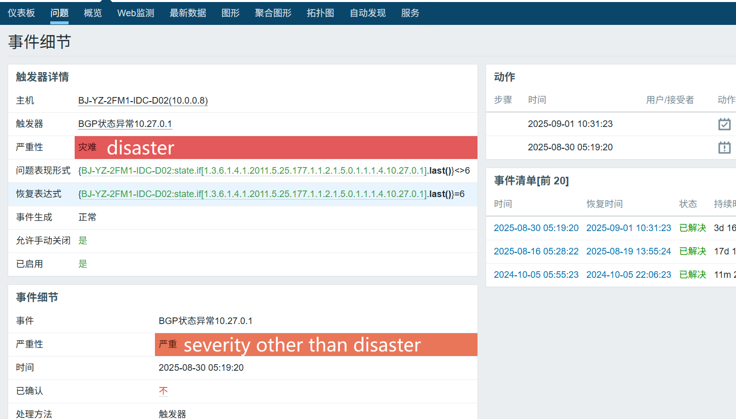

    but in the same switch, bgp state abnormal will not call action, it only display a problem in the problem dashboard. A weird thing is that the problem is triggered with desired severity Disaster, but it displays different severity other than Disaster in details page.
    I've checked role/permission, action log (no action), alert media, etc. and I could not find any thing useful... Could you please help me out?
Name:	problem details.png

    I'm not sure why it would display a different severity in the details page. There isn't some other template item/trigger that might be partially duplicating the behavior of your "disaster" alert, is there?
    Unfortunately I can't read Chinese, so I'm only able to partially understand the graphics you've included. I'm not sure there would be anything that would be a "clue" that would help me even if I did read Chinese, though.

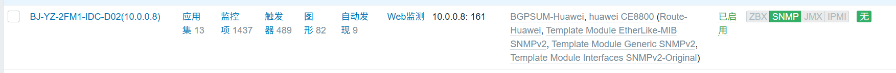

      yes there are multiple
Name:	zabbix multi templates.png
