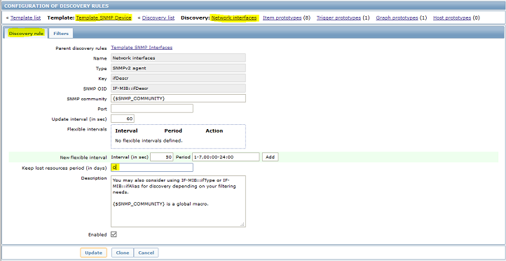

            Hello guys! I've been stuck on the same problem for days (I'm totally new on this). Would you explain step by step what did you do to solve it? Please add some screenshots if You can, I will appreciate it so much!!
            • wyang
              • Mar 2016
              • 93
              E.g., to configure the setting on template 'Template SNMP Device'. Click on 'Discovery rules', then click on 'Template SNMP Interfaces: Network interfaces', the discovery rule window will open, on which you could set "Keep lost resources period" to be 0.
              Hopefully the screenshot is attached.
