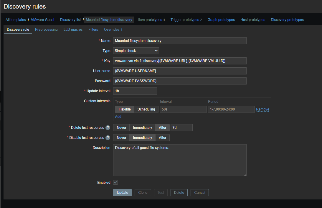

    But for some reasons, I would like to exclude specific items to be automatically discovered.
    Long story, short : we use Windows RDS servers with VHDX profiles, each profile is viewed as a partition ("C:\Users\<username>") and some of them trigger alerts that I don't want to see.
    Here is an example of autodiscovered items :

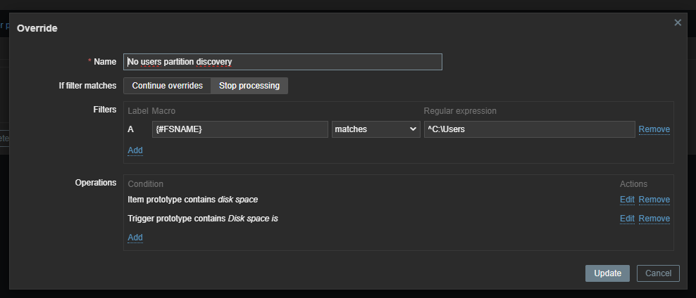

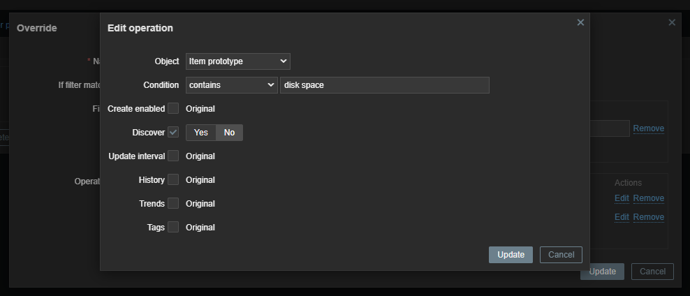

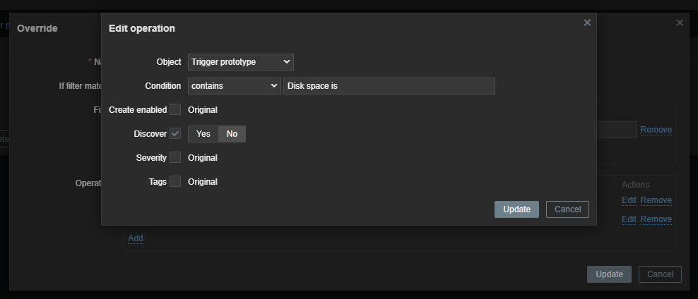

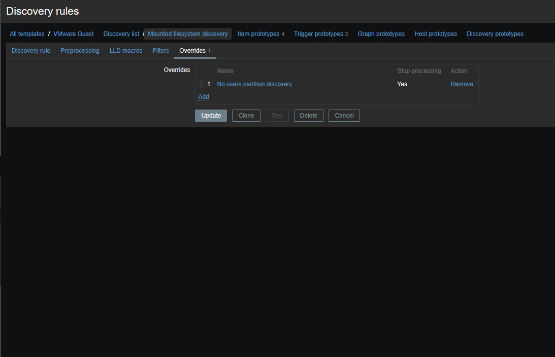

    I tried to configure an override on the "Mounted filesystem discovery" (from template "VMware Guest") :
    The main goal here is to not autodiscover items (partitions starting with "C:\Users") and linked triggers.
    Am I missing something or doing something wrong ?

          I found my mistake !
          That's on the regex, it's working fine when escaping the backslash (with a backslash) :
          ^C:\\Users
