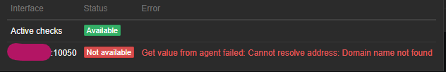

    My problem is when I add the MSSQL by Zabbix Agent 2, the server checks are still going through, but the passive connection shows the error in the title (Get value from agent failed: Cannot resolve address: Domain name not found)

    I've blanked out the server name (ie MYSERVER:10050).

    This appears to be a passive problem.

    I can suggest you to check first if AWS can access your DNS
    You can try to use command "dig" or "nslookup" to verify that
    As currently, I can see that problem is with DNS name and how host were added in Zabbix frontend
    To test forward DNS resolution of your MSSQL server, you can use following commands:
    nslookup MYSERVER
    To test reverse DNS of your MSSQL server's IP use:
    nslookup YOUR_MSSQL_SERVER_IP

      Hi, thanks for the reply.
      Yes, I agree that must be the problem, however, AWS is never going to be able to see into my network and resolve that IP/DNS itself.
      I thought that the purpose of the Agent2 was to provide that tunnel.
      It does work for the Windows Server by Active Agent2 is successfully connecting through on the same host and retrieves data.
