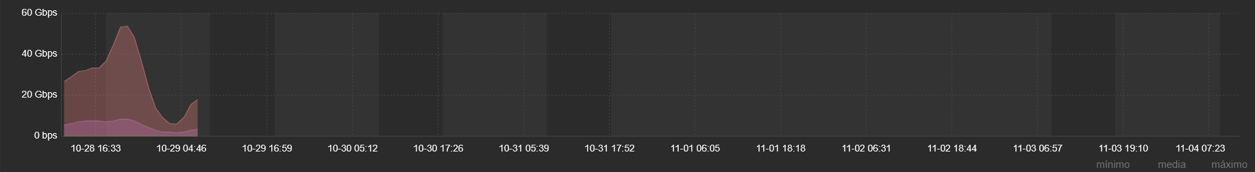

After updating to Zabbix 7.4.4, they stopped saving graphs older than 7 days.
  • cfrancis
    • Jun 2019
    • 17
    Since the update from 7.4.3 to 7.4.4, they stopped saving graphs older than 7 days.
    Click image for larger version  Name:	imagen.png Views:	1 Size:	19.6 KB ID:	508596

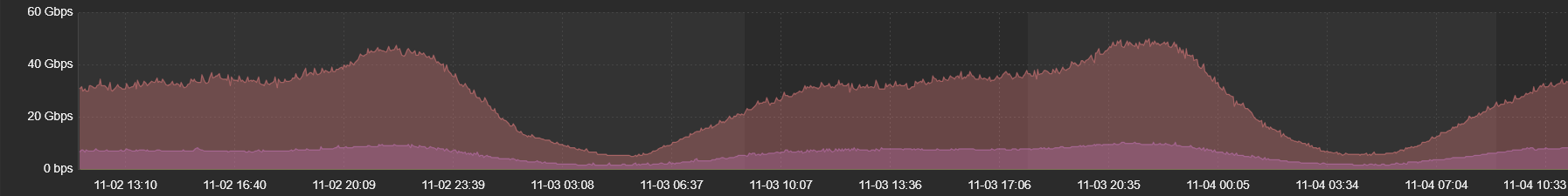

    Although there are graphs for the last 2 days
    Click image for larger version  Name:	imagen.png Views:	1 Size:	46.9 KB ID:	508597
    The date it stops recording is when it was updated.
